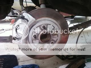

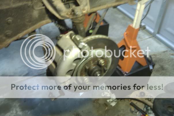

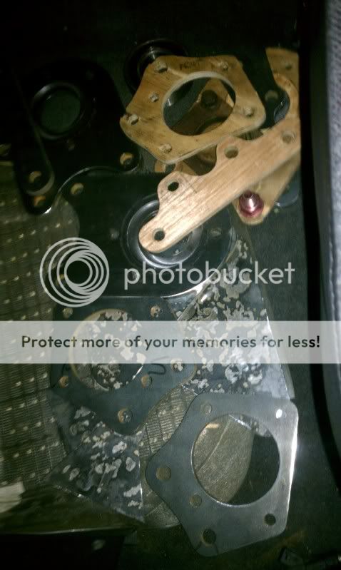

    so i got this idea from other guys who have atempted or have made, or are making. a 13 inch disc brake conversion. here are some photos of mach up on stock mustang, fairlane, 5 lug drum hub spindals. ill hope fully have the brackets cnc'd with in the next couple weeks. fully billet steel. its 05-09 mustang rotors and calipers. iwill be getting my hands on the cobra brembo brake calipers to make a bracket for those, enjoy. remember this is the rough draft, final details will be soon

    WOW!!!! This is gonna be GREAT!!!!:dance:
