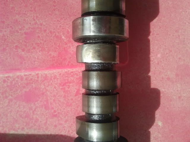

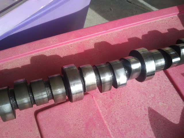

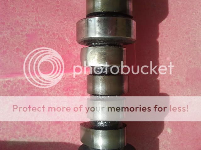

    I pulled the cam out today.. its F'd..
    I am looking at the Lunati barebones cams.. its a cam and lifter kit for 130 to my door.. I am thinking of switching to the 351W firing order.. anyone ever use the Barbones series cams??

    the springs on the car are a dual spring, no damper.. but they suck.. installed height is 1.825 and at that height they have 75#....fail..
    -.497 lift I end up with 210#.. double fail... so new springs are going to be needed.. even at coil bind the spring only has 260# open...
    the heads are 66 289 heads with screw in 3/8 studs, manley guide plates, hardened pushrods and Comp Magnum roller tip 1.6 rockers.. I'm curious what the bottom end is.. but not enough to pull the head..lol
