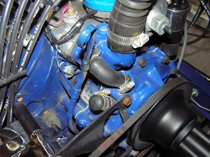

    Is it an issue with the little bypass hose? That's the only thing I can think of where the water pump and the water neck are remotely connected.
    Now that I typed that I have a feeling it may be due to the pump housing, maybe thicker where the two are close to each other?

    That looks like the neck for my 5.0 motor. I thought 302's were different.
    Micah
  5. Krazy Comet
    7,798
    2,483
    You're correct, orig 302 necks have a 45* angle...

    Could be, I just picked an image from the web for reference.

    Kind of hard to help when the pictures don't match the problem.

    Even harder when the OP doesn't return to join the conversation! BTW, I posted the picture in the OPs absence hoping to spur conversation with him which is why it doesn't match the problem.
