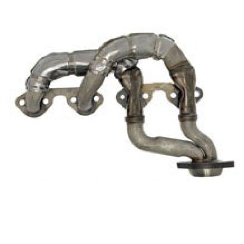

    Nice starting point. I, too, was going to suggest 96 to early 97 Explorer non-P Head, there are was markings on the end of the head to help tell the difference. Google is your friend. The motor has a roller cam, and a great intake manifold in demand with some Fox Mustang guys that can be sold off if you don't want it. It is the same as an old Cobra manifold. If you get a running Explorer, the rear axle is great if you shorten the long side. That comes with either a 3.55 or 3.73 gear and most are posi. They already have rear disc brakes. Like I said, one side needs shortening, and the spring pads need to be placed.
    Regarding stock manifolds on a V8 Explorer .... those are the WORST messes I have ever seen. Kind of like a tube header that sweep up to the valve cover. The Explorer has room under the hood, but in all the wrong places to work on a V-shaped engine. There is "other stuff" placed all around. I had a V6 Explorer and could not believe that you couldn't pull the plugs from under the hood. You can see them, but you can't touch them. LOL. Dive in and remove the inner fenderwells and you are right there .... silly stuff.
    Here is the exhaust manifold ...
