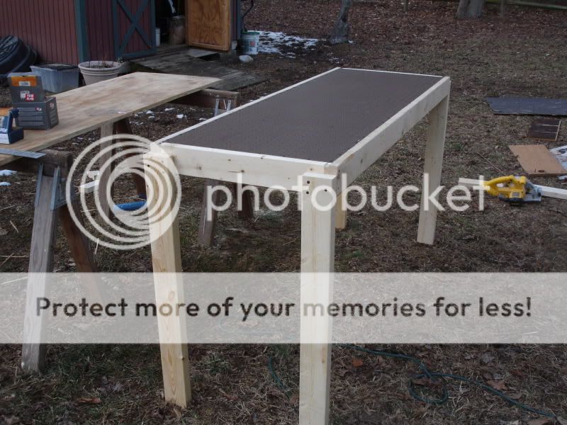

    I did not get to work on the Comet this weekend, but I did get something made. Anyone like to guess what it is?
    Some hints... it is NOT:
    an air hockey table,
    an ironing board,
    a cookie cooling rack,
    a hamster cage,
    But it IS:
    automotive related,
    something I hope to use soon,
    something that if it works, would benefit Comet and Maverick owners everywhere! :D
  2. SoupBowl
    SoupBowl Member
    Aug 23, 2007
    Houma La.
    1974 Comet
    A sanding or cleaning table?
  3. scooper77515
    14,671
    71
    It is pegboard. You will hang it on the garage wall and hang all kinds of cool tools and such on it!
    I am planning on putting about 6 times as much as that on my walls. Works for EVERYTHING!!!
    Except I don't get the legs....:hmmm:
  4. mercgt73
    mercgt73 Member
    3,828
    349
    Not a sanding or cleaning table.
    It IS pegboard... but it is not for mounting tools onto. And the legs hold it up, silly! What else are legs for? :rofl:

  6. mercgt73
    mercgt73 Member
    3,828
    349

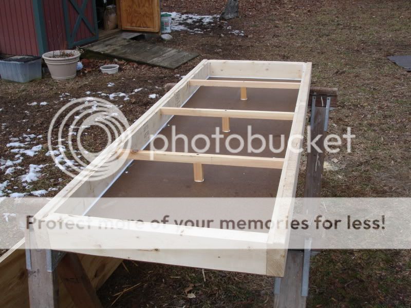

    A few more hints:
    This is a prototype. If it works, I will make another one out of steel (at-least the top part with the holes in it).
    Also, the bottom of the 'table' is closed... and there will be a hole in it next week. He is what it looks like under the top:

  8. RMiller
    RMiller My name is Rick
    Dec 12, 2009
    3,933
    1,004
    523
    Kennewick, WA
    1971 Maverick Grabber
    A base for a home grown sand blast cabinet.

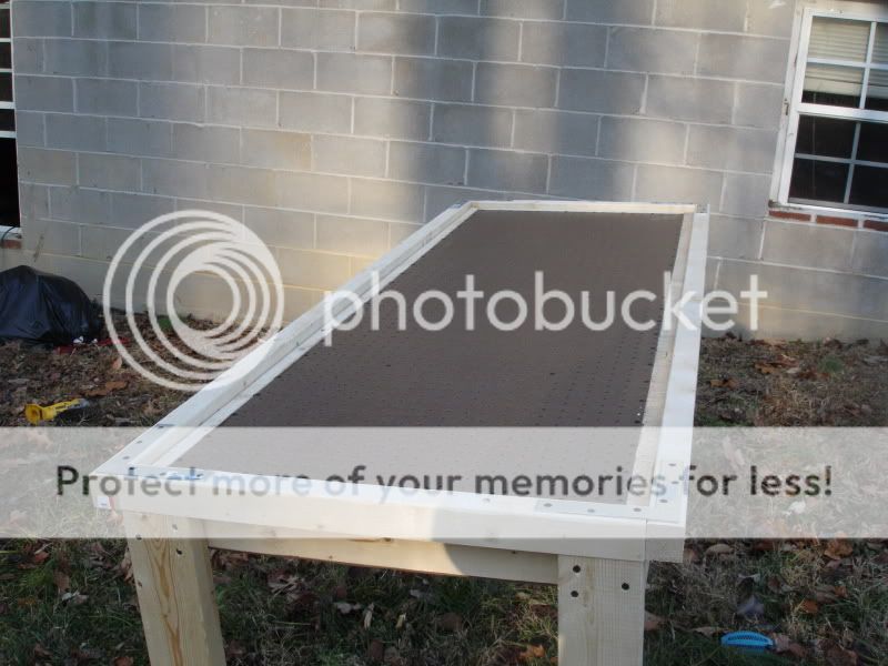

    Another hint: The outer frame on the top of the table is removable, like this:

  10. Dave B
    16,924
    209
    Are you going to vacuum form something?
  11. Moneymaker 1
    Oct 21, 2009
    2,933
    Panama City Florida
    Some sort of vacume table, what you makin'?
  12. mercgt73
    mercgt73 Member
    3,828
    349
    You got it! Its a vacuum table.
    I am going to learn how to vacuum form our dash pads. Mine will be the test bed. I have researched it, found how-to's and spoke to people about it. Just like what justdashes.com does, but ofcourse not commercially and with much smaller equipment.
