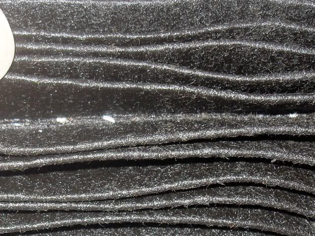

    Fram doesnt use cardboard. Its practically the same type of media used with purolator.
    Here a is cut open used 8A
