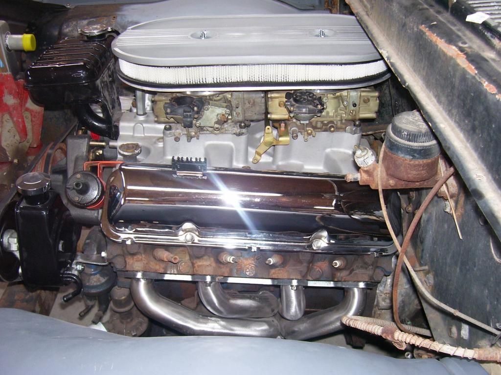

    Here's a pair of them on my '62 F100 unibody. Yes, they mount backwards on a factory 8V setup so it looks a little different.
    As a carb, they are nothing fancy but they work. They won't over carb you, have good throttle response and if you use the re-usable gaskets are cheap to tune.
    SPark

    I've never seen backward-mounted carbs. I've seen them sideways on tunnel-ram and blower setups.
    How does the throttle linkage attach??

    This is an OEM system for a '63 Galaxie dual quad. The throttle linkage hooks to a bell crank bolted to the base of the rear carb, it then actuates the gold pieces of linkage seen in the picture. The original carbs had a shorter stroke on the linkage so that's why the side linkage on the carbs looks different. The engine runs off the front carb until you reach around 40% of throttle travel then the progressive linkage brings the rear carb into play. The front carb also has choke linkage and the rear does not have a choke. All this linkage is reproduction of Shelby Mustang linkage from Tony Branda Mustang Parts.
    The reason they are backwards was the original carbs used would not clear the distributor cap unless mounted backwards. These are not original carbs but they are the same configuration so they mount the same way. If you picture it, the primary side of the front carb is sitting right where the primary side of a normal 4 bbl setup sits on the engine. It's pretty trick for 1963.

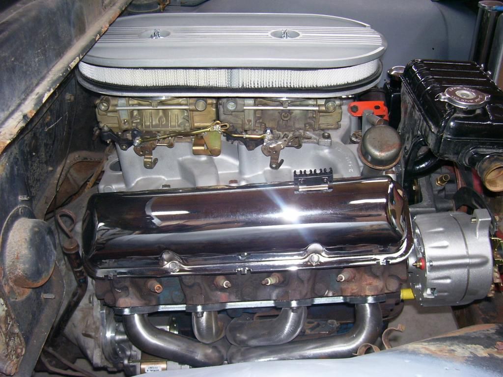

    Here's what the driver's side looks like:
    The big gold thing bolted to the base of the rear carb is the bellcrank assembly. One hole on it is for the throttle linkage and the other is for a return spring. In this picture, there is just a plug in the distributor location to keep crap out of the engine. The engine is a 390 with a 428 crank (makes a 410).
