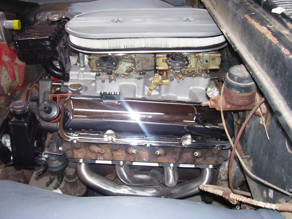

    You need to replace the secondary pod tops and drill them to install a balance tube to get em opening at the same rate. I used the same setup (twin 1850's) on my 427 but ran them with a 1:1 linkage, with a balance tube on the secondarys

    The balance tube tops go on when the carbs get rebuilt. This is just mock-up to be sure I could get all the linkage to work. Had to do some trimming on the carb base for the bellcrank pivot to clear the baseplate and slightly modify my original '62 throttle pedal to get everything working correctly. I'm using Holley kit #20-73 so I still have quick change tops and the balance between the carbs.
