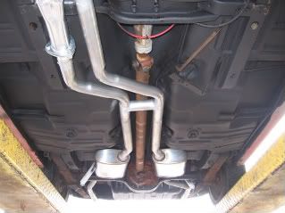

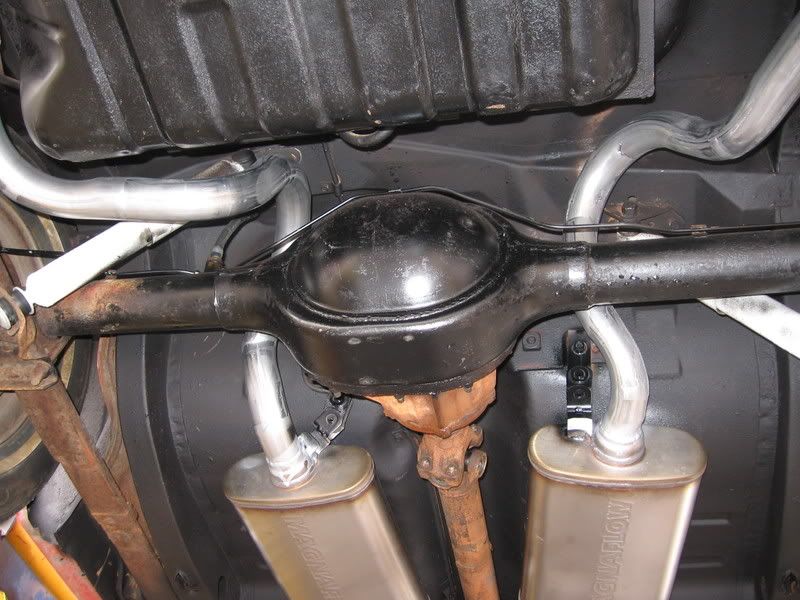

    If you are planning to limit your mods to minor ones I would not go over 2 1/4 inches on your exhaust system...more like 2 inch would be more than adequate. Go with a dual collector header so you can run twin pipes out with dual mufflers. This is my setup with 2 inch pipes all the way back.

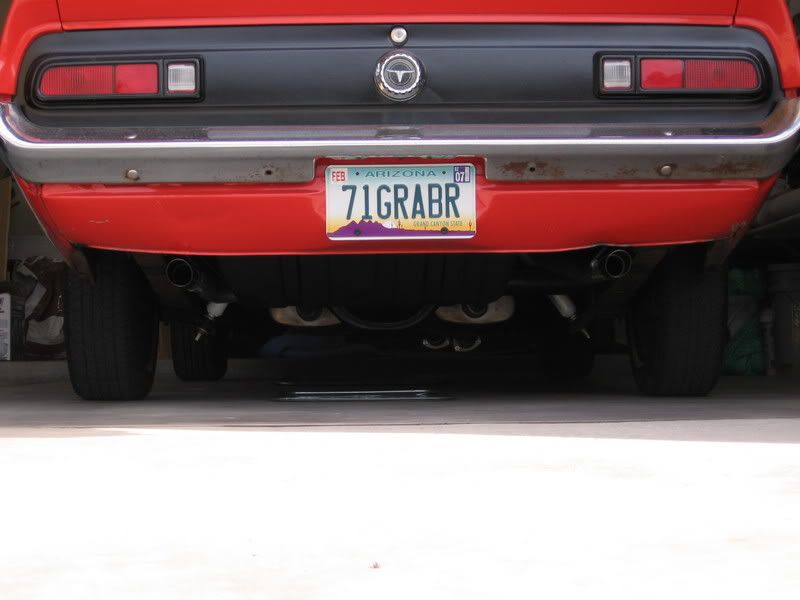

    Nice set up....you have the pipes (dual) coming out on one side?...any pics showing the pipes coming out from the back?

    My pipes are split all the way out the back. A good muffler shop will be able to do this with no problem.
