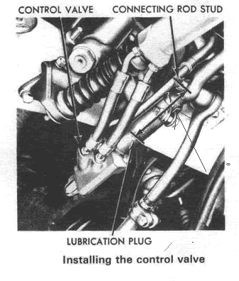

    Tried to point it out with an arrow on this pic:
    There was a locking pin there, to keep the control valve from moving sideways in the threads..
  10. blugene
    10,775
    Could you use drill bits to try and determin the size? I know they (roll pins) don't cost much and they can be found at auto parts stores and Home Depot.

    It's just that there doesn't seem to be a hole on the other side of the link, so beating any more on it wouldn't be much of a point if that's true :)
