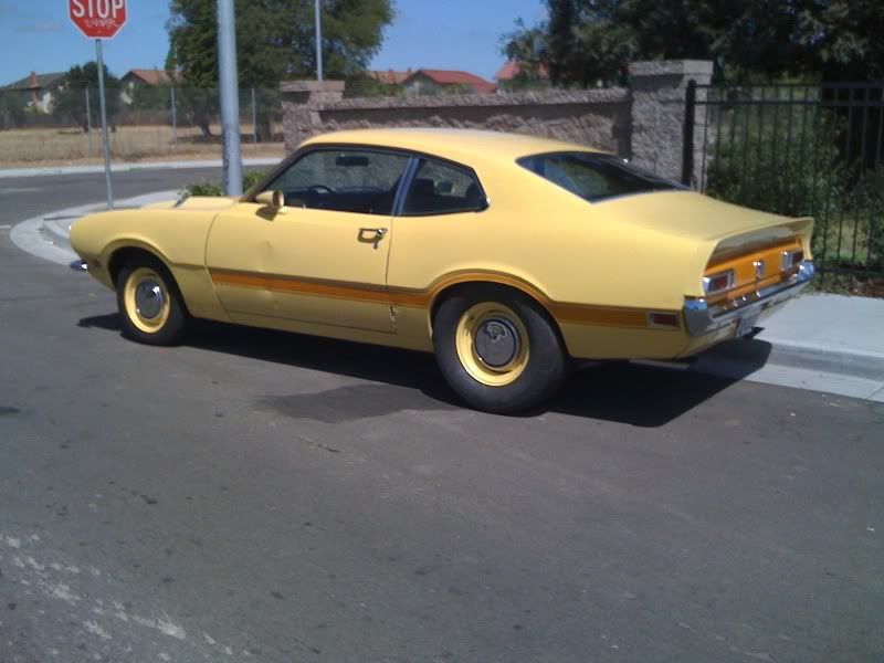

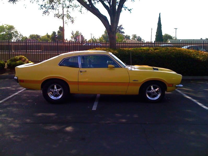

    Very nice! :dance: Thank you for the picture. Very nice car. I guess the second pic is before the paint? That pic looks like my car. On the new paint is that the original color? It looks to be much darker but I like it better.

    I would like to eventually like to paint and stripe like 7D2's car, but it would be nice to just have an ok paint job for now so I could just drive the car with it looking ok. Lot's to think about.

    Most of the car is original paint, the side without the stripe has been repainted once and the fender was spray painted to match.
