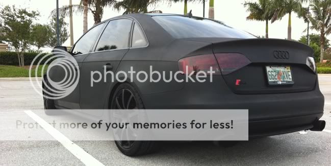

    I see some reflection on the firebird, like the trucks taillight. probably pretty close to what we would need but just the pic is on a cloudy day.
    I talked to a paint guy and he said there is just a flattening agent to mix in with the clear coat and wouldnt be a big deal.
