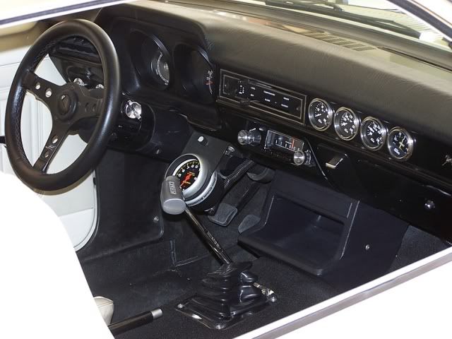

    Nothing will stay in mine.
  5. mavgrab302
    Lmao, you'll have to install a safety net over it.... Nice car :tiphat:

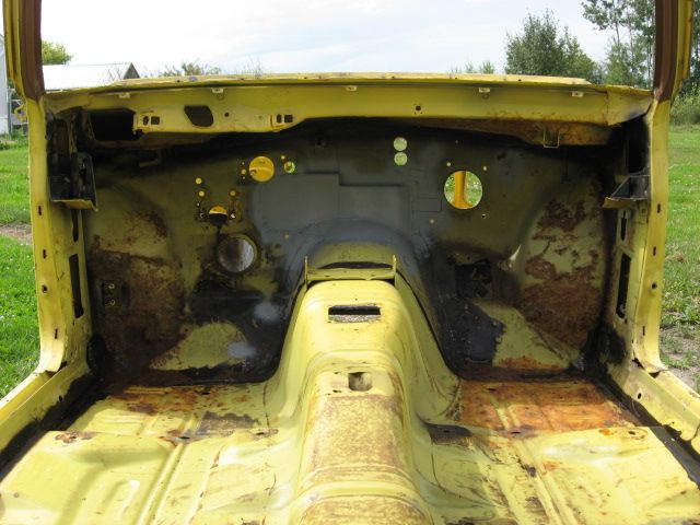

    If you want to mount it as in a Pinto, keep an eye out for the floor bracket.
    In the picture below you can see it just in front of the shifter hole. I can take better pictures later today if required.
    You would need a spot rivet drill bit to remove it.
    Picture is of another car I'm working on. Firewall & trans tunnel mods done in such a way as to keep the original heater (hey, I'm in northern Alberta !). Moved the 2.5" main wire harness hole up & to the left, so it doesn't come out behind the left head/valve cover. Lots of finish work to do next summer: it's in storage right now.

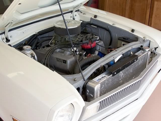

    I'm such a big fan of the "Big engine - Little car" culture :dance:

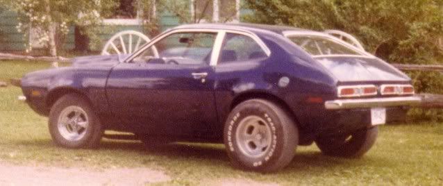

    My first car was a 72 Pinto. Drove it home & pulled the whole drive train....replaced with 302w, FMX with 3k stall & a Mustang diff.
    Second car was a 72 Pinto as well:

    Actually, not BC lights.
    First one got squished between two full sized cars & shortened 3'. Didn't blow up ! :rofl2:
    Body guy thought it was "funny" to install a couple extra Pinto lights. :16suspect
