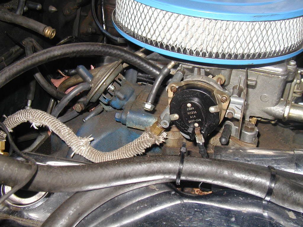

    That is what I was thinking too. I think I broke mine, and just removed it plugged both holes with pipe plug.

    ill take a pic tomorrow and post it

    yeah i have a heat tube with sock laying aroudn somewhere, loving my electric choke now! It sits on teh passenger side rear of the exhaust manifold and is about the size of a brake line, with a flexible metal tube that connects to wind up to your choke. At first i was thinking the hose that directs heat to the air cleaner, but that is much bigger nearly 2" or so, transmission dipstick should sit much farther back and should have the dipstick in it...
