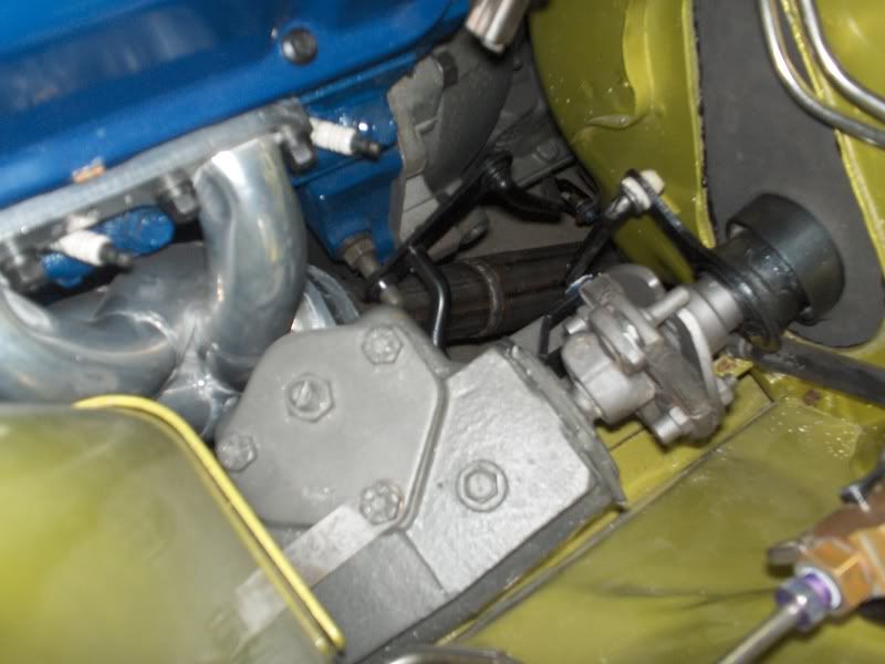

    I wonder if anyone has installed these successfully clearing the pit-man arm.I thought these would fit better than any other headers since they are specially designed for the maverick, but apparently not.
  4. Bryant
    have you contacted thorley yet?
    i would be having a very serious conversation with them on how their direct fit headers come no where close to leaving any room for the stock steering to operate. you should see if you can find an e-mail address and email the pics of the problem areas to them then call them and tell them you have emailed the pics. be ready to send them again to the person you get on the phone if they give you another email addy.

    I called twice today and he didn't answer. His mailbox is still full so I sent Doug Thorley support an email with the pictures.Ill let you guys know once I hear from them.

    Mine go back at a different angle, and didn't use the supplied collectors, we also used a short section of 2" pipe, to gain some clearance. I've been using those headers for over 5 years now, with no issues.
  12. Bryant
    dave, do you have any pictures from the bottom or any other angles?

    Hey gang, It's Jamie from thorley. It's great to see the site doing well and seeing all the same familiar faces again.
    Valente, I received your email this morning but since I was a previous member here, I think it's best to address this problem here on the message board.
    The headers were in fact developed specifically for the Maverick/Comet. They fit a T5 just fine but not a 4 speed. The reducers are a little long but they are made to be cut down. Perhaps in the future, I will consider just supplying a shorter one since the flare portion is all you really need anyways. In all honesty, the tight clearance between the pitman and the header was a slight oversight on my part but since we've installed and sold 100's of these, I felt it was easily overcome with a visit to a capable muffler shop. I think the SFI bellhousing does compound the problem as Craig mentioned though. Maybe you could possibly pay visit to another shop to get a second opinion? If that doesn't pan out, you may also give us a call and we'll work towards another solution. My voicemail will be cleared out when you do. I don't spend a lot of time at my desk but if you wish to speak with me directly, just ask Troy or Mike to drag me out of the shop for you.
