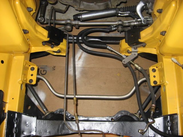

  11. bryson123

  12. rthomas771
    8,093
    981
    Master Parts Catalog shows a different part number for a Maverick cylinder. 70-71 Fairlane and 70-up Maverick used the same part number...67-70 Mustang used a different part number than the Maverick/Fairlane. The valve assembly are the same part number.

  14. Krazy Comet
    7,793
    2,480
