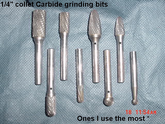

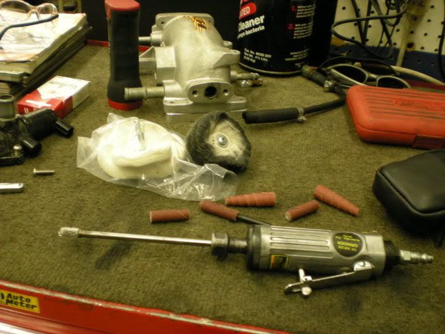

    i ported my stock heads out and notced a diffrence
    and my friend destroyed a GT40 head after geting greedy and not wanting to stop porting and broke into a water gacket on the exhaust side :biglaugh: after i toled him to stop
    i would port any heads i plan to put on my car
    it's is to easy not to do it
    just smooth everything out and take down some of the sidewalls for more direct flow
    i use these bits to port it
    mine are like these
