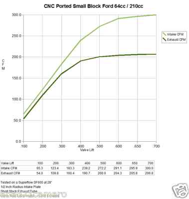

    What do the Procomps 230's flow at .600 for a 420cu I would want no less then 300cfm @ .600 on the intake.

    Here's the flow chart from the link that is on my original post.
    One more thing, when you say, you've been runnig the MSD stuff for years wiyh no problem, are you talking about the procomp MSD style stuff?:)

    Ok here's the bottomline from my experience with procomp. If your buying get bare CnC heads. Its just simple as that. I bought assembled procomps for cheap and they needed tons of work. The springs were wrong, the valves wrong, seriously they had a 2.05 valve in a 2.02 seat. The casting was horrible, took a lot of porting to clean it up. With CnC work done most of the flaws are cleared up and make for great head. Install beehive springs with ferra valves and rev to 7k+ all day. Just a word of caution the CNC procomps have large runners due to the CNC process. I would have had the CNC work done but I wanted to keep my 190 runner. They offering me an awesome price to upgrade to cnc with bigger valves but I passed.
