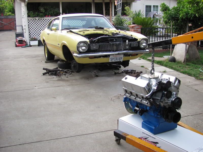

    oil pan
    Once they installed the March serpentine belt system and the air conditioning compressor they discovered that there was no space for the stock oil dip stick. Their solution was to install the high capacity oil pan. Now I'm worried it won't fit in the space between the control arm mounts. The engine will be delivered this afternoon. I'll make measurements and pray a lot!:cry:

    Good luck, I hope it works out for you. You can always notch the pan if nothing else works. Keep up the good work

    this was the sulution to what problem...you still need a dipstick...:bouncy:

    You should still be able to use the dipstick on the side of the block. I'm sure they used a latter roller block so it should have the hole on the side for the dipstick. Don't forget pictures of the new beast when it comes in.

    The engine arrived this afternoon. I suspect that I'm going to have a clearance problem with the Moroso oil pan. They used this pan because there was no clear route for the stock dipstick to go. I called Prestige Motorsports and given what I paid them, made it their problem to solve. They're the experts and know what the engine was going it.
