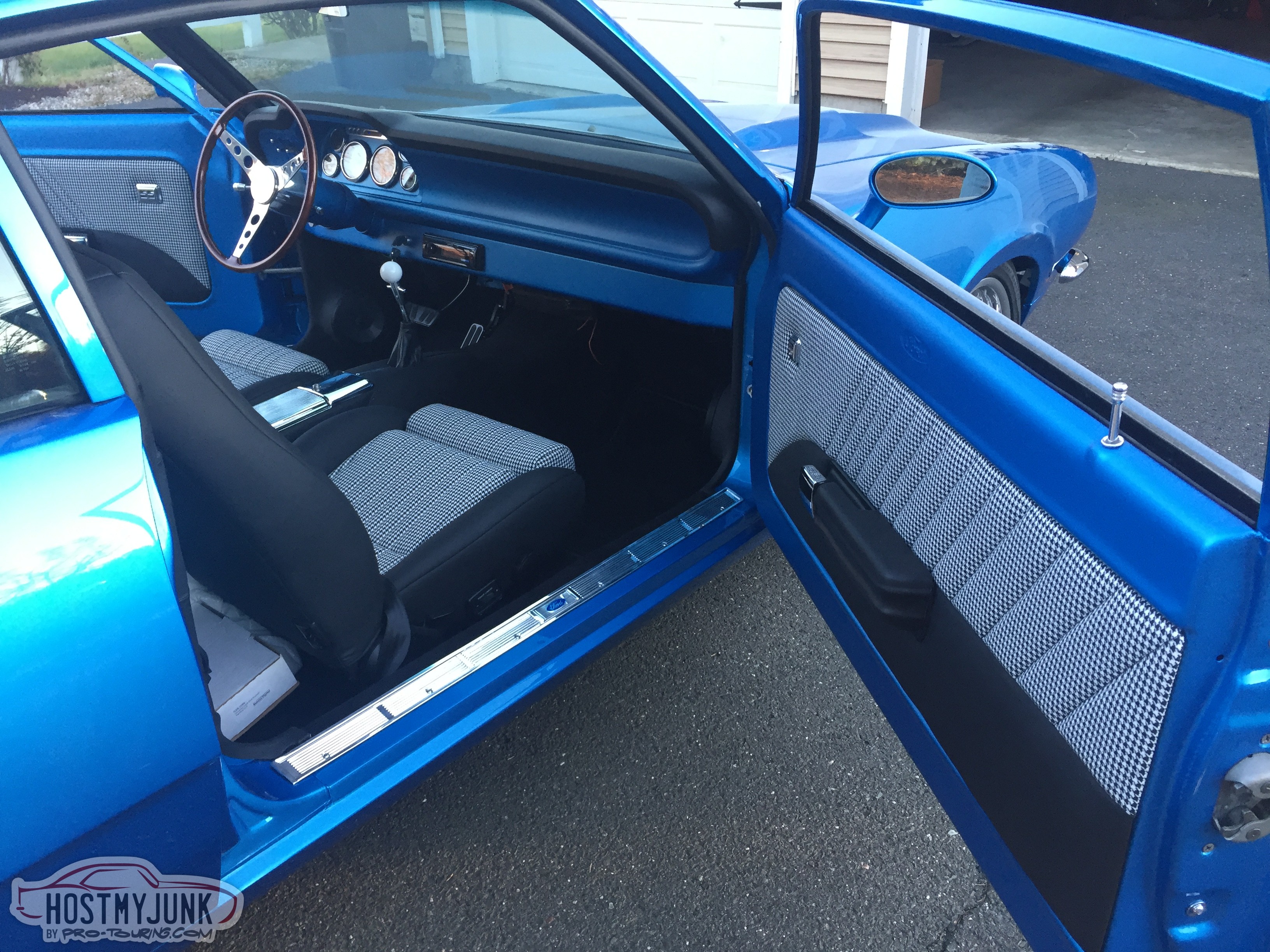

    Progress on the interior has been slow, but steady. Door panels are now installed for the last time. All new reproduction arm rests and handle are being used as well as the power window switches from for the windows. No more cranks! We decided to have the pleats spread out as they go towards the rear of the car, just something a little different.

    Nu-Relics made them for me several years ago. They are a direct bolt in replacement for our window regulators. Easy as can be to install. I was the guiniee pig and sent in my OE regulators that they made patterns from. I believe they are now available to order from them.

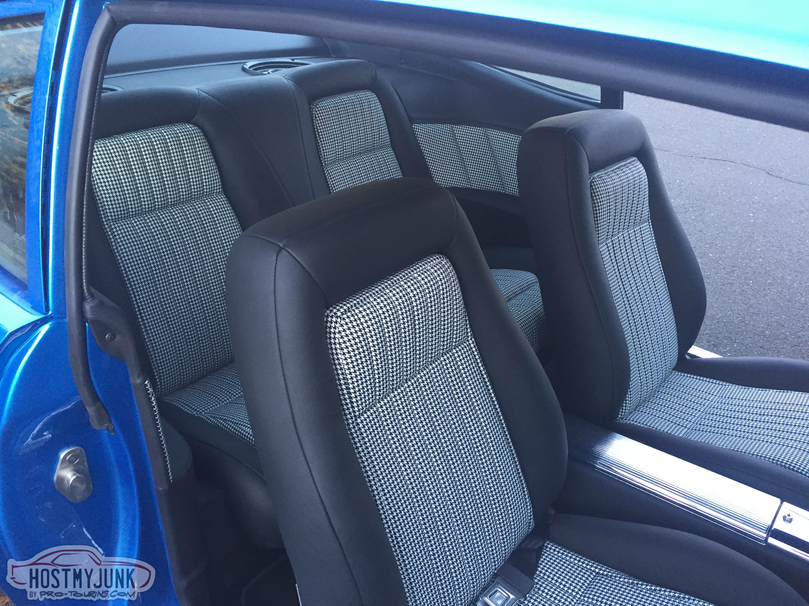

    Back seat is now done. I love these pictures, but have to say this all looks sooooo much better in person. IN the car, in the shop it just doesn't photograph that well.
    Only thing left now is the kick panels and center console. Then onto the trunk.......
    In an effort to make the back seat look as if it belonged in the car to begin with, the side panels were recontoured to match the side of the rear seat. The side panel normally go straight up top to bottom. That matched the factory rear bench. But because my new seat has a tapered contour, my upholstery guy built up the side panels to match the seat. Making it look as though it came that way from factory. The first picture illustrates where he added to the side panels.
    This second picture shows it now upholstered and how it flows as though originally made this way from Ford.
    And here is the back seat 100% completed. By using a second set of front bucket seat foams he was able to make the rear bench look exactly as the fronts with all the bolsters and contours. Even the knee bolster is in place just like the front seats!

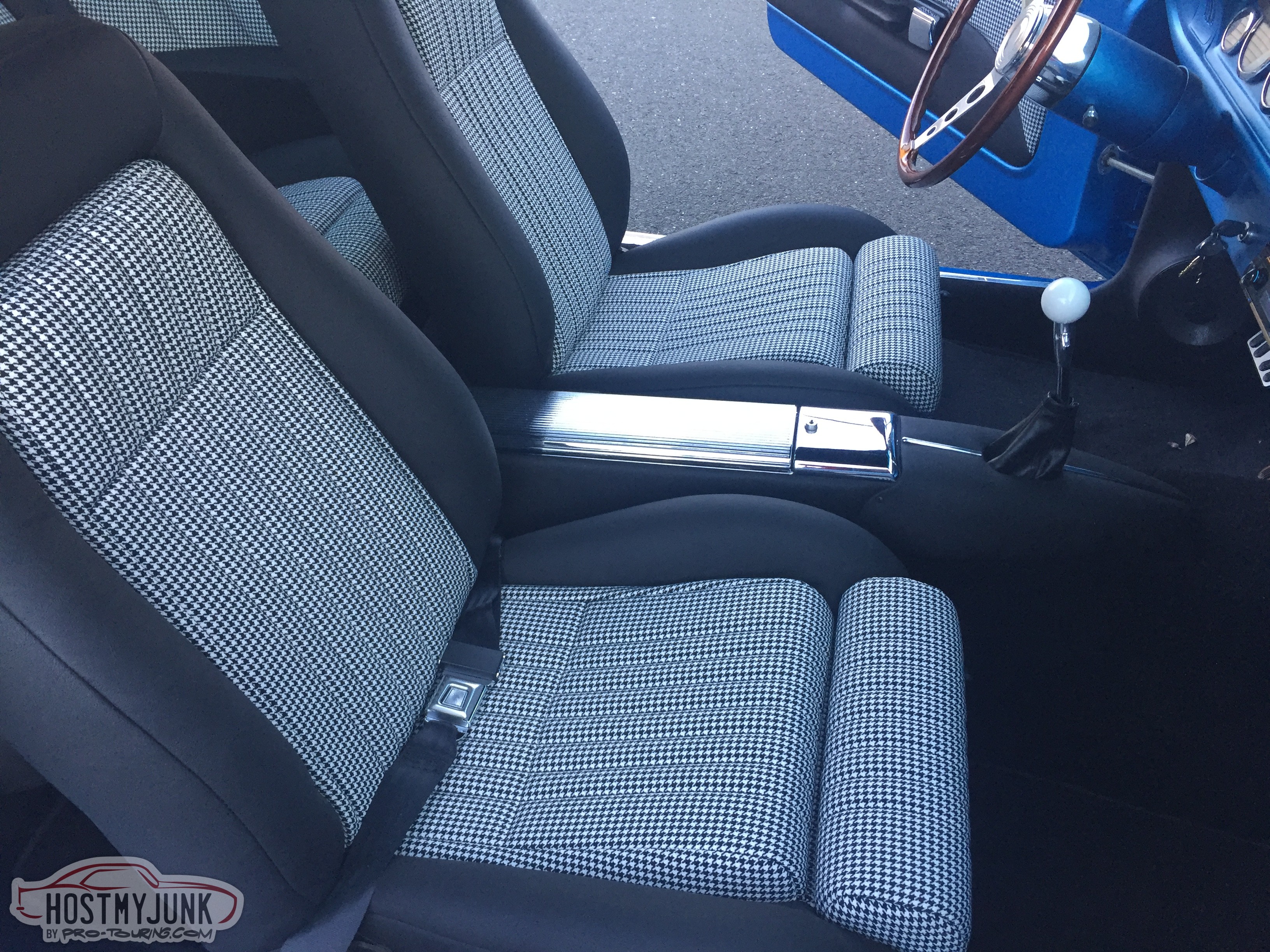

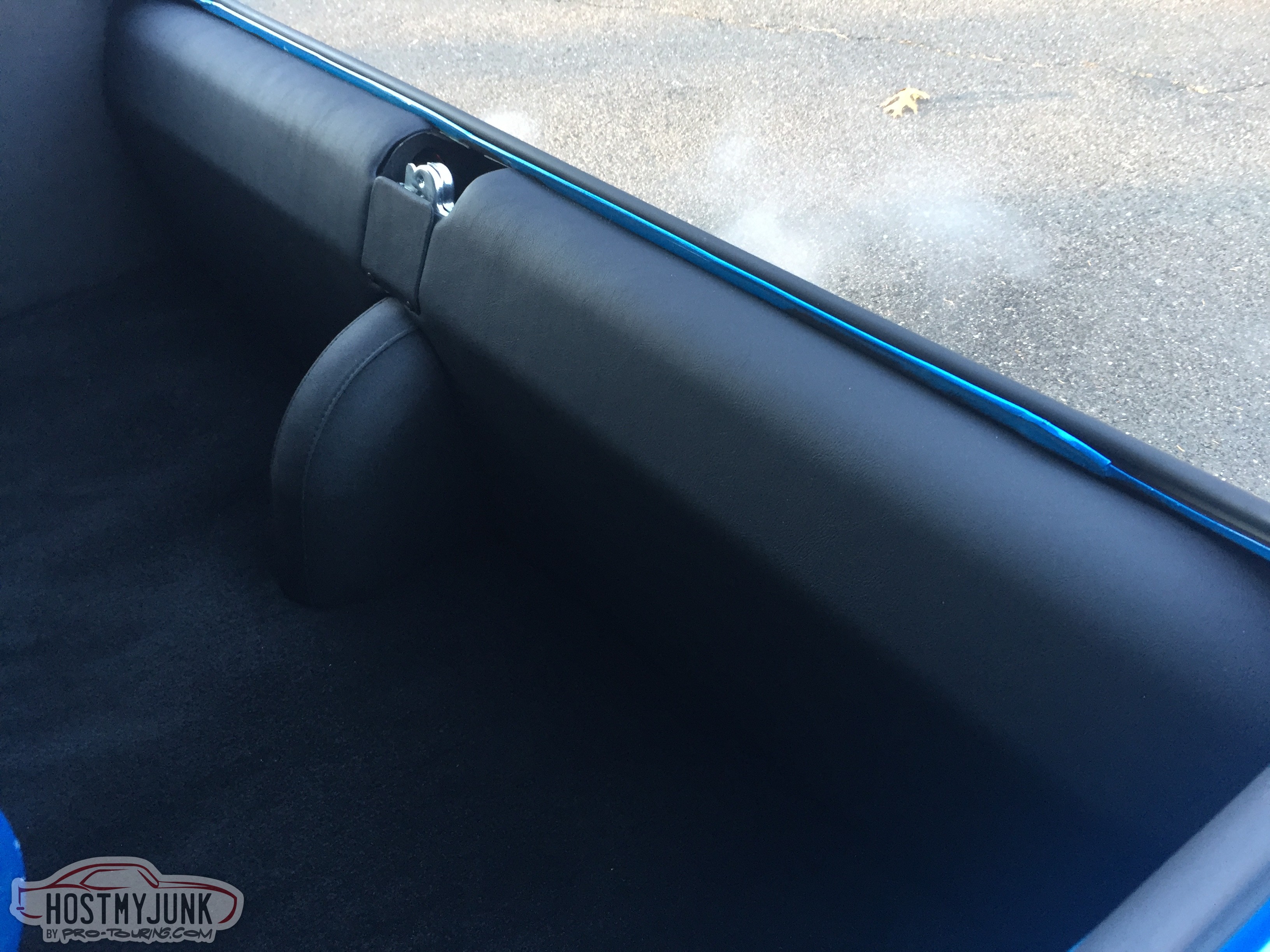

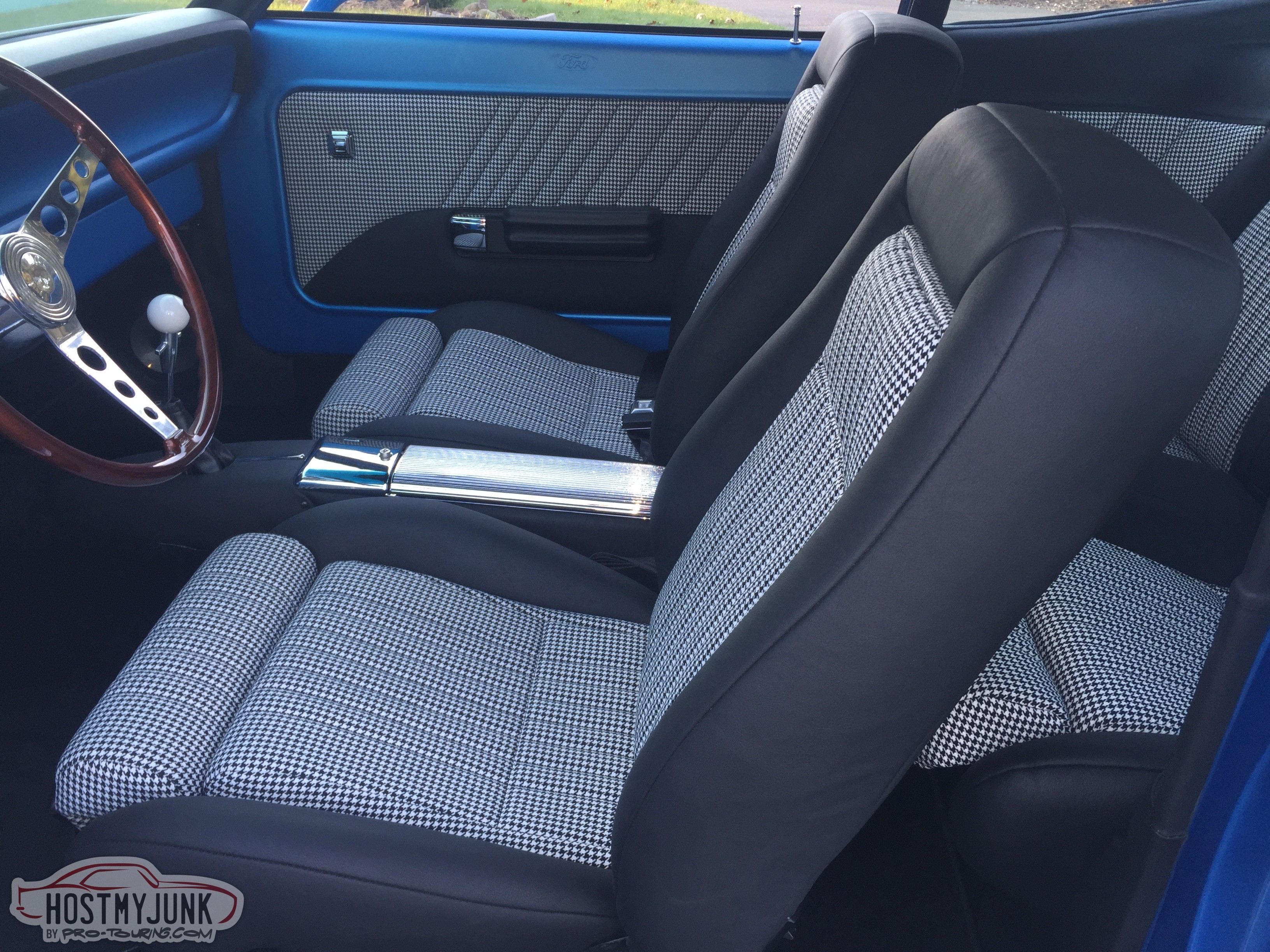

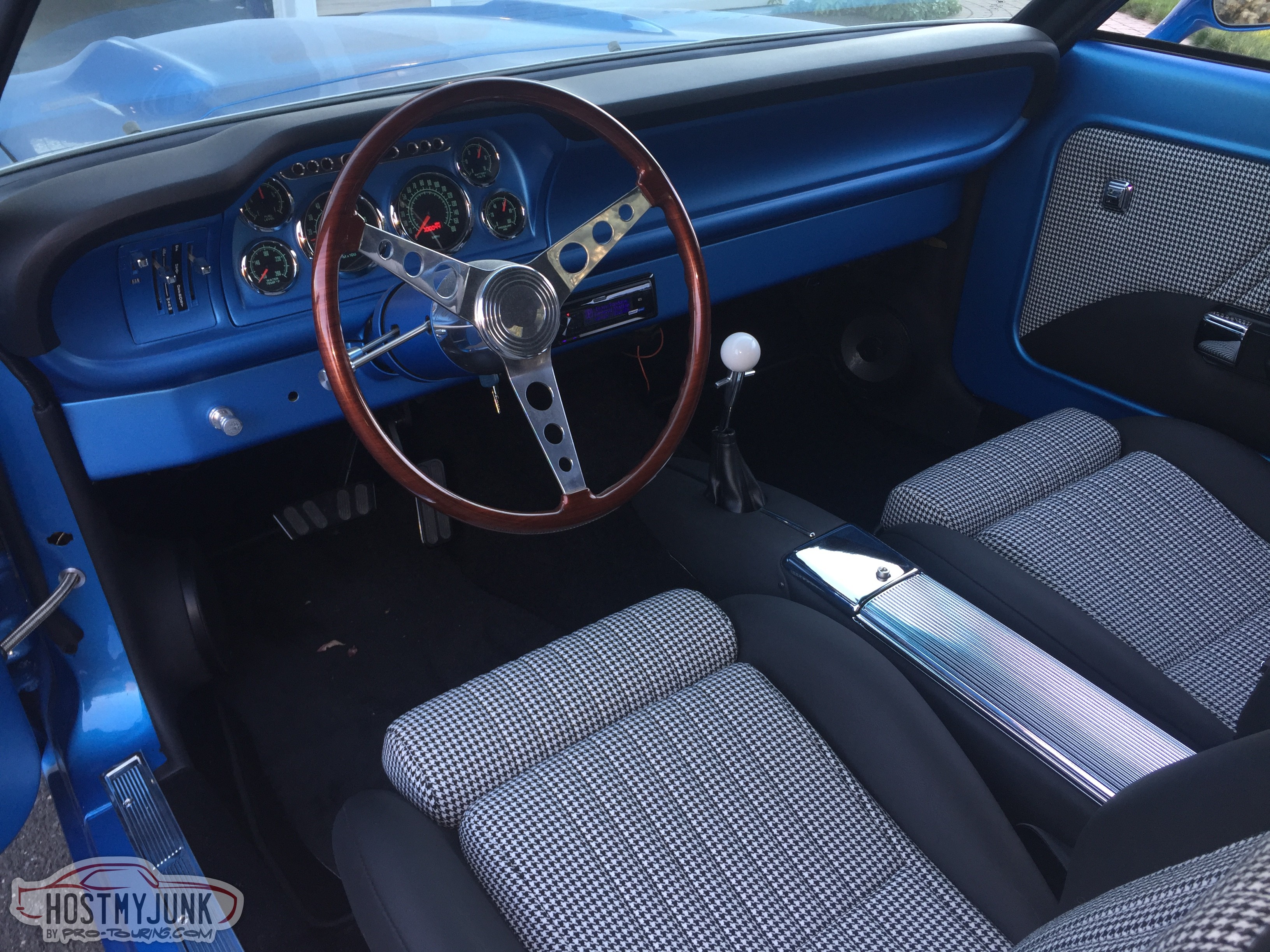

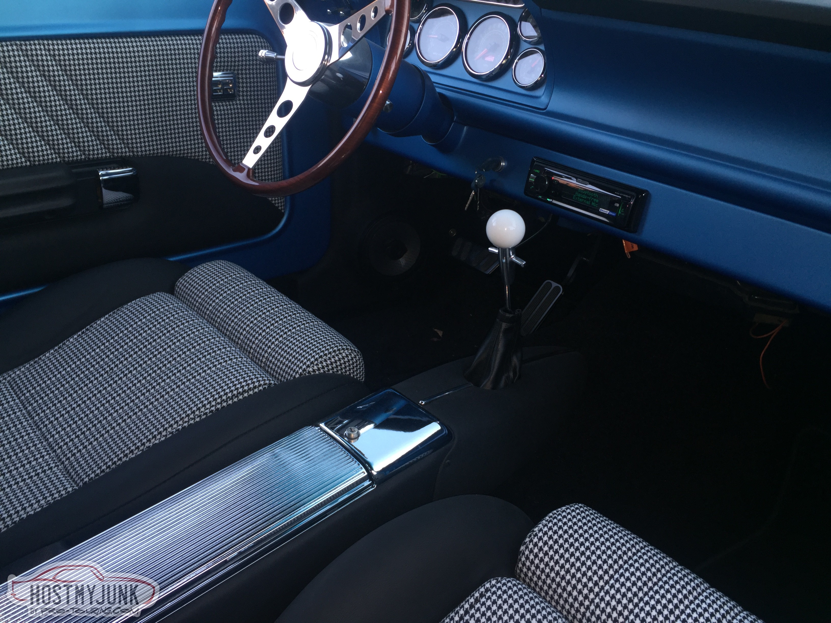

    Back to the Maverick now. The interior is now done and home and I LOVE it. My upholstery guy is really good. Not cheap, but really good. There just short of 140 labor hours in the interior all together. Tons of custom touches here and there. The doors and power windows work so well. Nu-Relics products fit and work perfect. Having all new NOS tinted glass helps with a final touch.
    Lets start with the trunk, now fully upholstered......
    And now for the front with seats and center console installed.......

    I love the console. What did it come out of?
