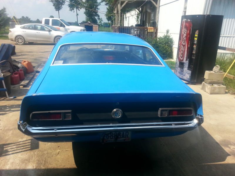

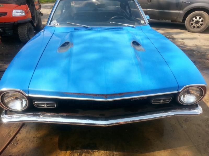

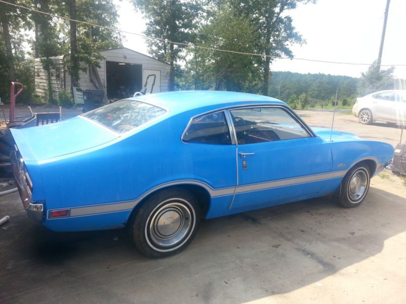

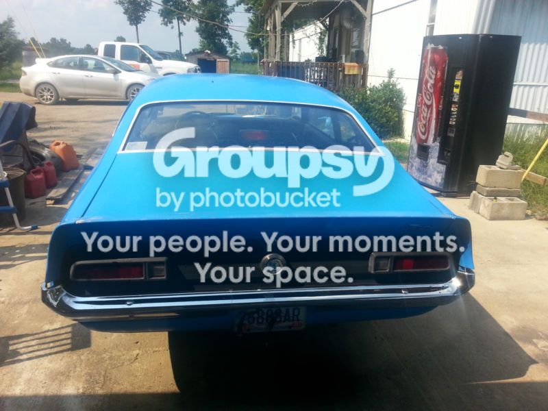

    Here is a few pics that sold the car:
    It is the original paint, cleaned with some sort of harsh chemical (wire wheel acid) but does buff up. The car has a few dings in it that i'll likely have the local ding king take care of.
    The plan is to not paint the exterior, but polish it up and let it show off it natural beauty.
    Ive thought of naming the project Coyote Ugly....as some of the grabber blue cars look great online, I don't think mine does... I can't get my head wrapped around it here.
    ALL of the trim is there and in good shape with minimal dings and the interior is okay...

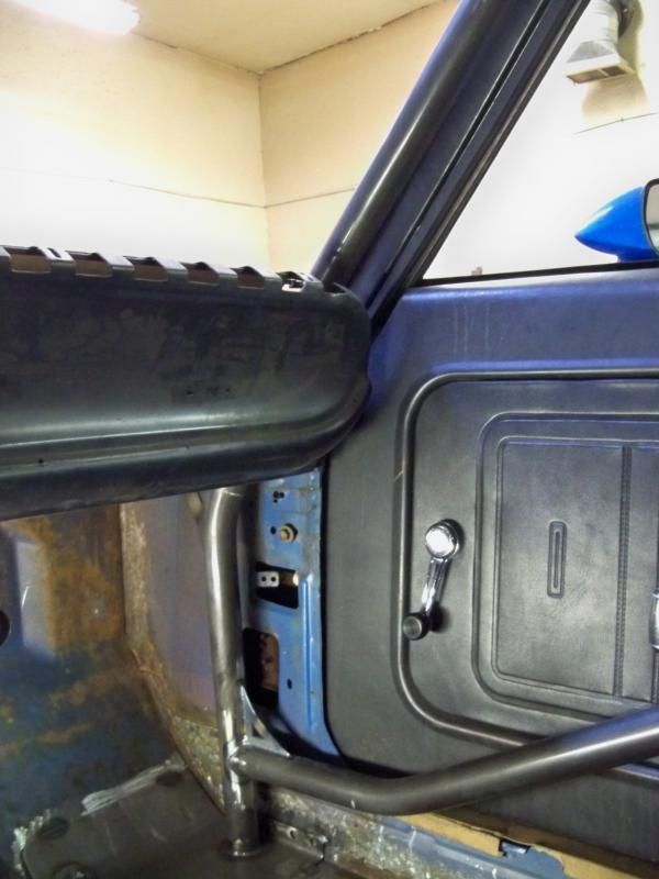

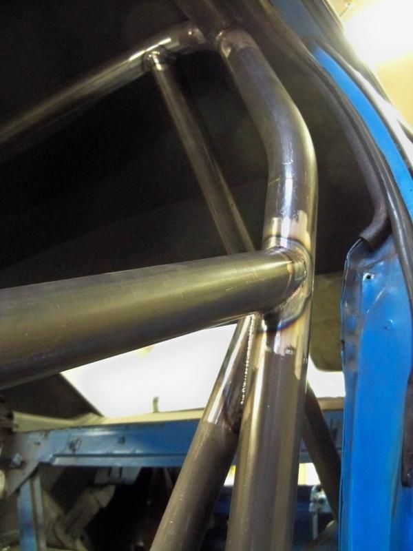

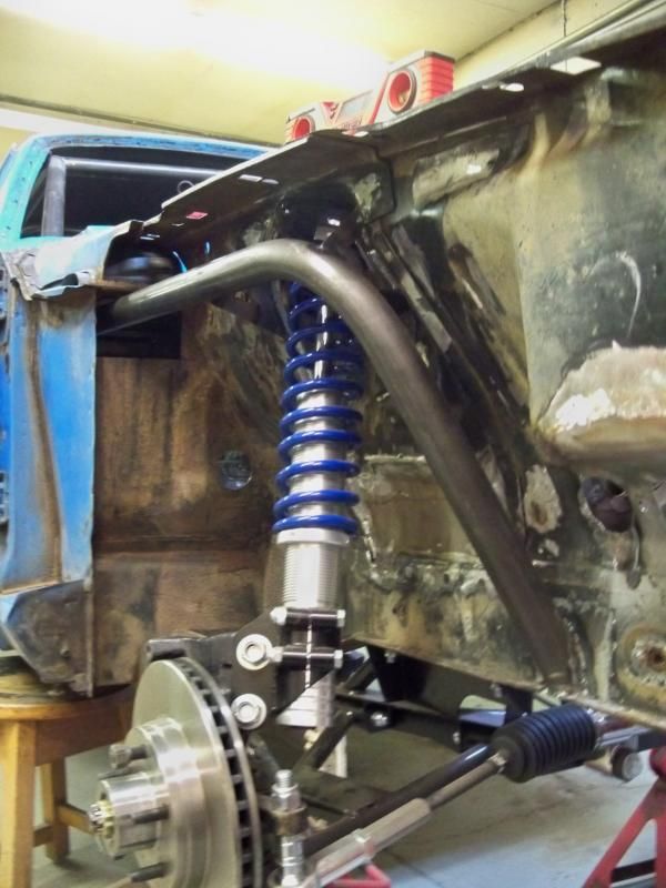

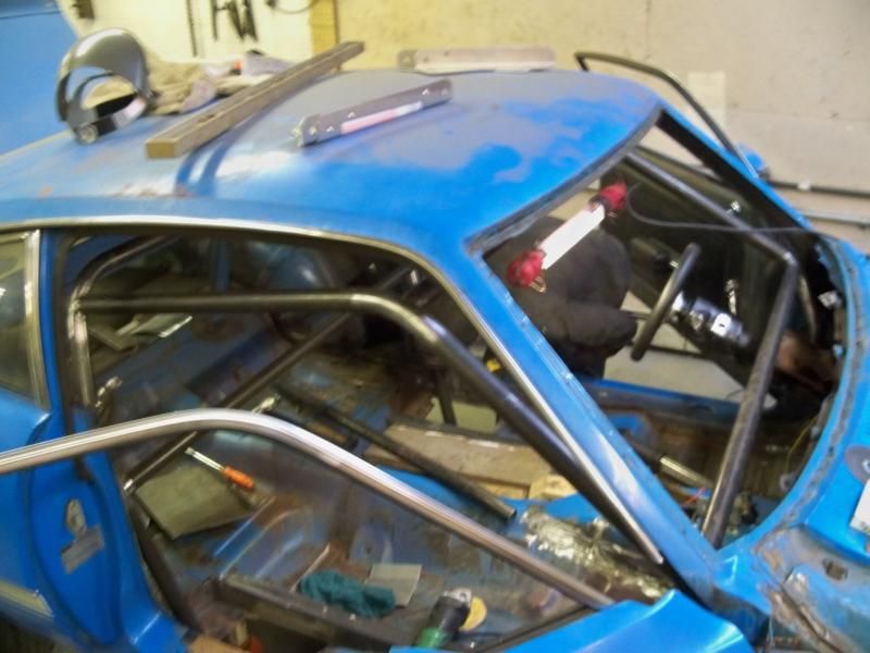

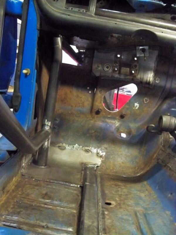

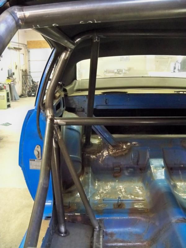

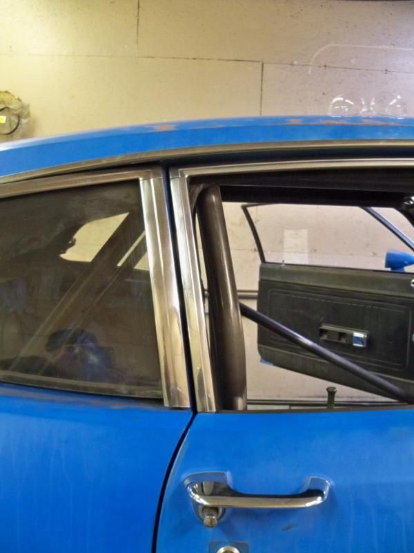

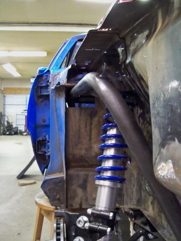

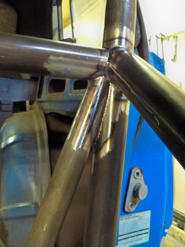

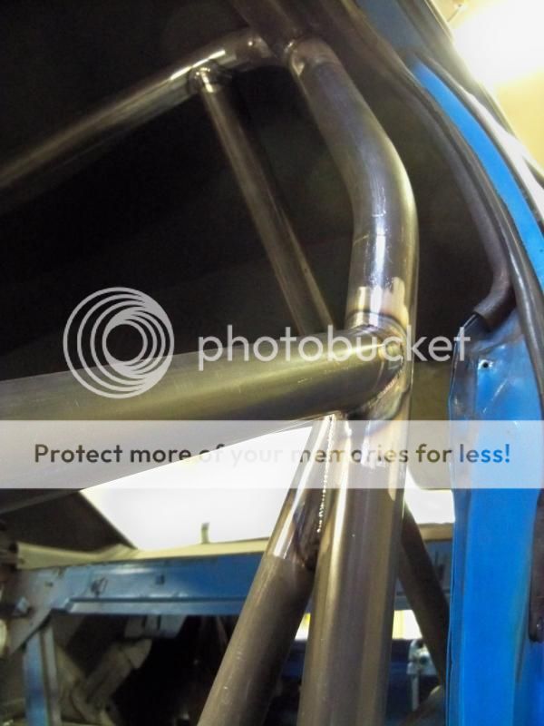

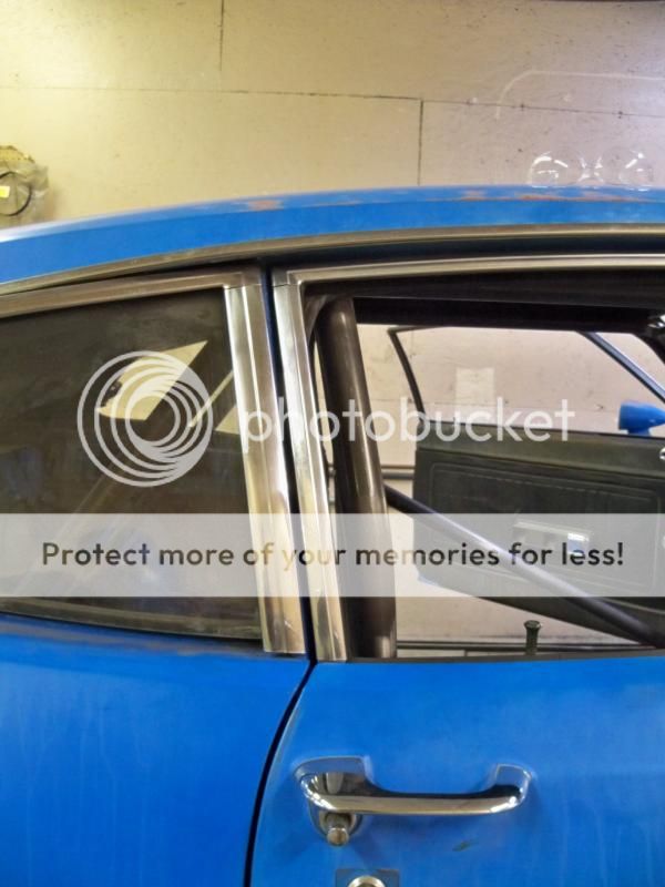

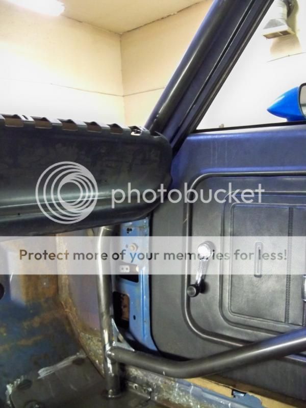

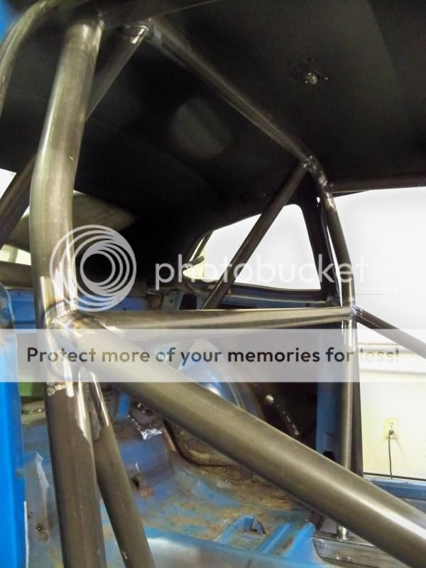

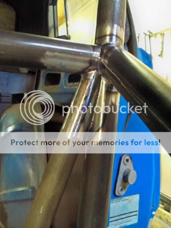

    So here is a few pics of the cage, my buddies chuck and jay at CHE hooked me up with the time and space to make it happen.
    The cage is 8.50 certifiable, and you will notice the front bars that are actually gusseted to the factory shock towers which were moved out about 4 inches on each side to allow clearance for the Coyote Crate Engine.
    The AJE K Member went in as easily as expected.
    I will get pics of the rear of the car soon. The rear is a narrowed explorer 8.8, spool, mosier axles, and spool, aerospace disc brakes, using afco shocks, caltrac bars and caltrac split monoleafs moved in board about 2.5 inches on each side.

    Really nice work on that!
    What part of FL are you coming to?
    I am next to Clearwater, the beach side of Tampa.
  15. Dave B
    Nice cage!
