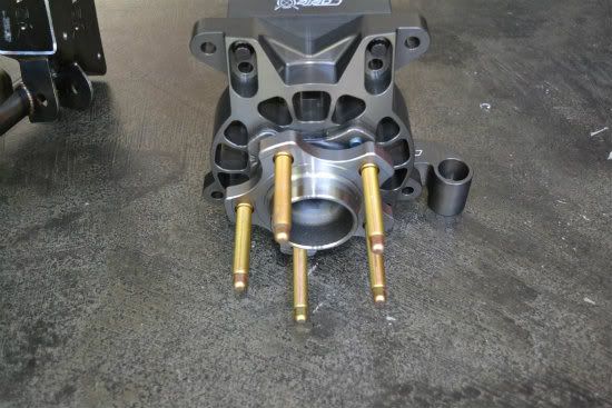

  4. Dave@RACEWARE
    Dave@RACEWARE Member
    Mar 3, 2006
    184
    New Britain, PA
    73 Maverick Graber 72 Comet GT
    I had a break in the conference I'm at in Phoenix and figured I would post some pics of some parts so you guys can droll at them. I sure did we I opened the crate. This is the SLA front suspension from Cortex Racing. it's a bolt in kit for 65-66 Mustang that is close to a Maverick but not an exact fit. The package consist of the bolt in K-member, adjstable upper and lower control arms and their ultra trick billet spindles. www.cortexracing.com

  7. Dave@RACEWARE
    Mar 3, 2006
    184
    New Britain, PA
    More pictures of the Cortex billet spindles. thet are truely a work of art.

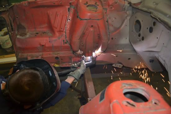

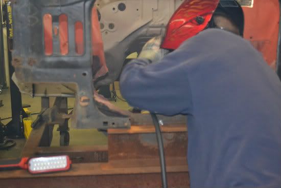

  13. Dave@RACEWARE
    Mar 3, 2006
    184
    New Britain, PA
    Knowing that the Cortex K-member was not the same dimension as the Maverick frame rails the decision was made to fabricate a new perimeter chassis, besides the torque boxes were not in the best of same anyway. I have to say though it wasn’t far off but just enough to mess up all the geometry that Cortex built into the k-member.
    So the next step was to turn the kid loose with a plasma cutter. He removed just enough material to set the k-member in place.
    [​IMG][​IMG][​IMG]

  15. Dave@RACEWARE
    Mar 3, 2006
    184
    New Britain, PA
    You can see how much of the frame rails we had to remove to get the k-member square and level in the car. Surprisingly the Cortex K-member is not far off the factory Maverick rails.
