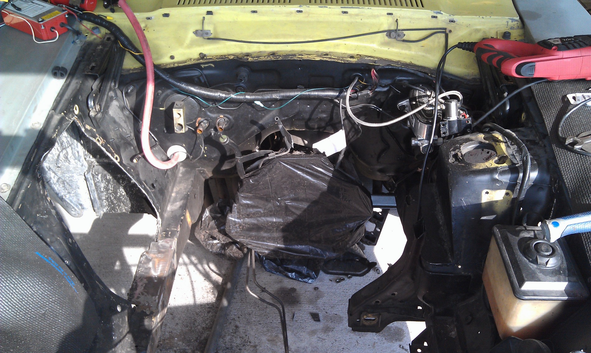

    I'd love if someone could show a top down picture of the engine compartment after doing this mod. Curious how much of the chock tower goes and what it looks like. Thanks!!
  2. 71gold
    2,936
    here is mine...
  3. scooper77515
    ALL the shock tower comes out.
    Here is a shot without the replacement panels in. I still haven't gotten around to installing mine.
    This is sort of a before AND after pic all in one. Passenger side stuff is removed, but haven't started on driver side yet.

  4. mav1970
    Quite the contrast photo :yup:

    Thanks. Those showed me what I wanted to see. On the panel replacements did you just screw it in place or weld??

    Also curious how you all determined your frame rail centerline. I see the instructions that came with the product but they do leave a bit to be desired on some topics.
  7. scooper77515
    They can be screwed, bolted, or welded. I kinda like having mine out completely. Much easier to access suspension stuff. So when I finally get around to it, I will use nuts and bolts, rather than welding.
  8. 71gold
    2,936
    I bolted mine on... gives plenty of room for plug change, header install, etc,etc.
