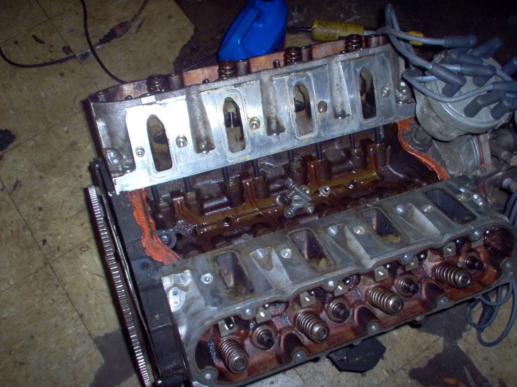

  14. ModMav71
    ModMav71 Member
    Feb 23, 2006
    773
    Sebring, FL
    Yea there's actually a couple articles out there about a guy that was putting LS1 heads on a 302. It was pretty interesting...dont know what ever came of it though. If I hadnt been so set on keeping mine all Ford I would have put an LS1 in my Mav. They are great engines! They have been putting out 400hp since 2005 with the LS2. And Fords just now got a small block (the new 5.0) that will keep up with it.
  15. maverick75
    9,017
    http://mmb.maverick.to/showthread.php?t=39489&highlight=LS1+heads
