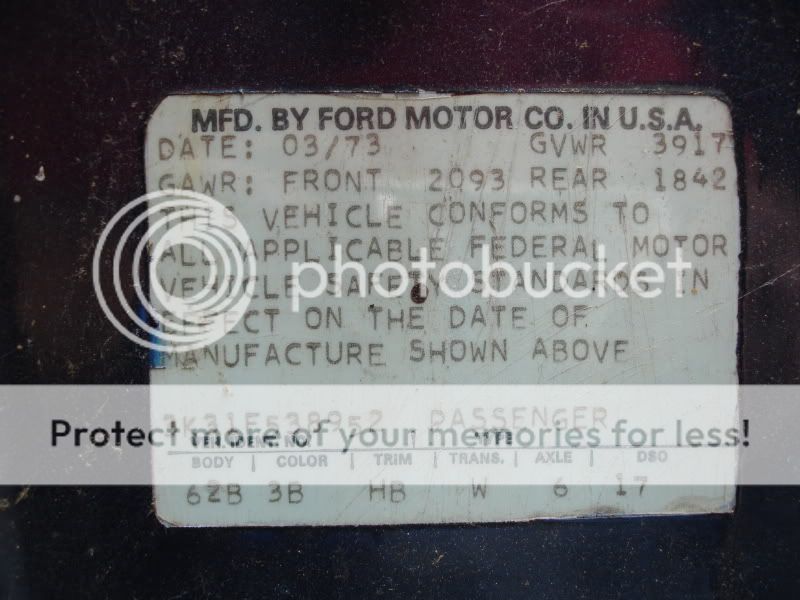

    My 73 has 2.79, factory AC and C4. I can't say that it was/is the original gear ratio, but believe it is original. There is nothing to indicate it has ever been changed, the metal tag is still on the housing/pig.

    Yep. 1973 Comet, 302, C4, factory A/C with 3.00 gears.
