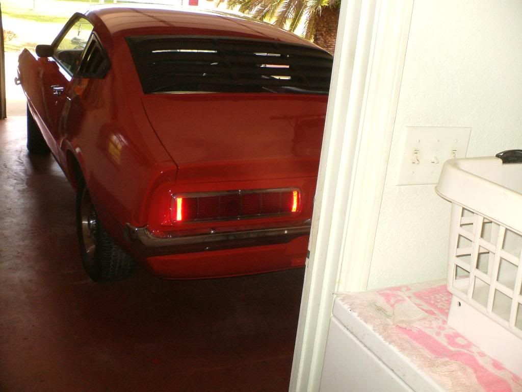

    Here is the one Wesley sent (mustang656man)
  15. mustang656man
    mustang656man Member
    Oct 8, 2009
    fl
    66 mustang,65 must convrt,68 must convrt,74 maverick-modfied,76 maverick
    What I had to do to use the mustang louvers is to cut off 3 slats worth and then they didn't cover the stock rear window opening so I used a kit to reinstall rear window after installing a mustang headliner(another mod which didn't come out so good) and then installed stainless and added ever so little body filler to finesse gap and on the bottom of the louvers on each side I left a tab to tuck in by the window stainless and 2 stainless screws across top of louvers to attach to attach on roof. The trunk lid is able to be opened about 12 inches without removing slats but slats only take a minute or 2 to remove. wes
