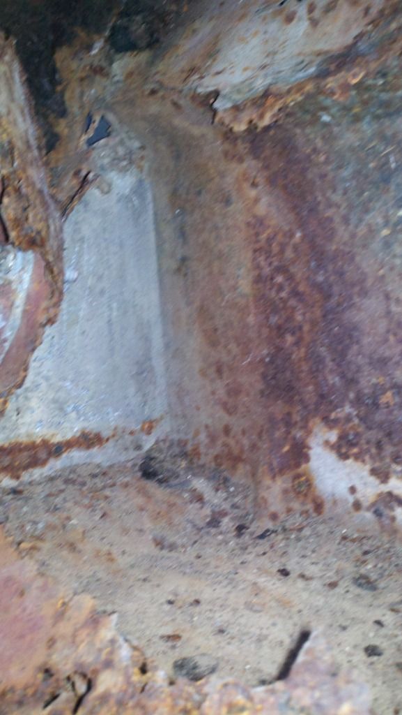

    That is why i try to buy projects from the southwest....The amount i pay to ship them is worth it compared to fixing stuff like that....Been there, done that

    This car is actually the first maverick id ever seen. Belonged to a friend of my dad. It looked like a kick ass fast back. I bought it for $1500 and think about selling it from time to time but then I fire her up and take a trip around the block.
  3. b_ryce70Mav
    b_ryce70Mav Member
    Jan 7, 2005
    453
    Shaw AFB, SC

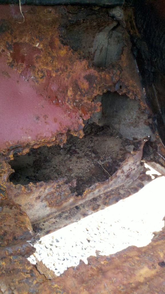

    My torque boxes were bad (not as bad as yours) and my cowl hats were completely intact. The underside of those things just traps so much dirt. Fortunately for you somebody repops torque boxes now. I highly recommend looking into buying those as they were not around when I did mine and it was a huge pain.
  4. 72Mavguy
    72Mavguy Member
    Sep 19, 2007
    Tennessee
    1972 maverick, Factory 302, soon to be mav Grabber clone
    Do you know who remakes them? If they're cheap enugh I might as well just replace instead of rebuild.

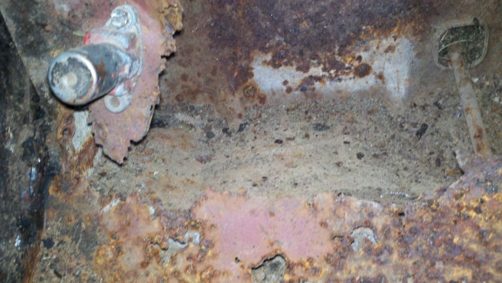

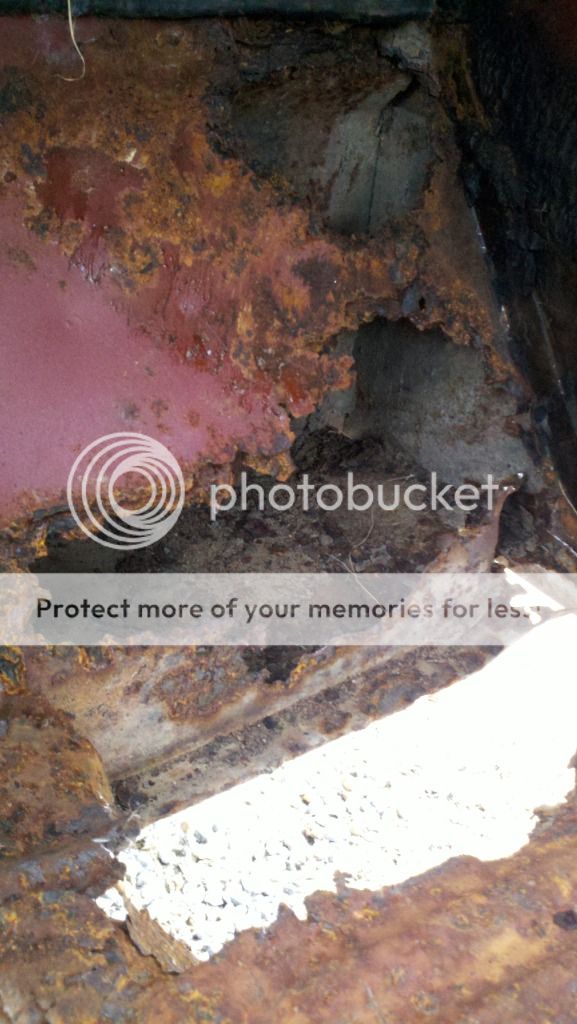

    Few more pictures of the cancer I'm battling...
  6. Tannersg1
    Tannersg1 Member
    Aug 10, 2011
    1,362
    227
    Classified
    Call Joe at Period Perfect Parts Group (3PG). Thats where i bought mine. Replacing these can be an adventure so do your research!!!!!
  7. mav1970
    or contact Rick Brooks on this forum for decent, mostly rust free, used Texas parts. I got a complete torque box from him with only surface rust issues that cleaned right up :tiphat:
    http://mmb.maverick.to/member.php?u=5289

    Update...parts maverick has busted driver window = completed rotted floorboards... BUT torque boxes appear. Perfect :huh: oh well floorboard fab is easy plus i have torque boxes
