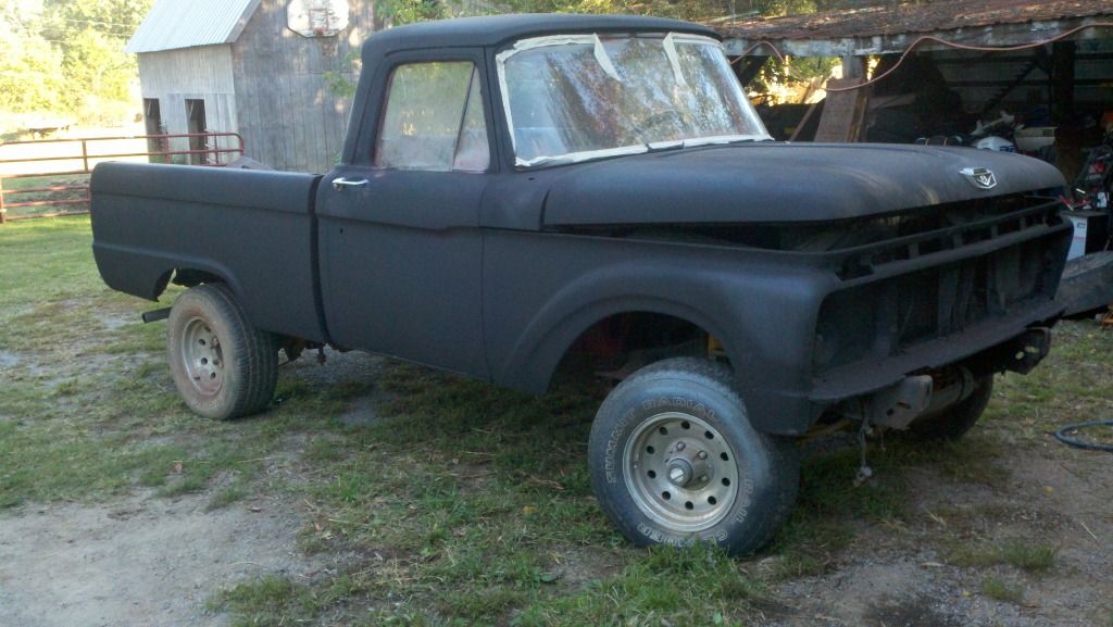

    this is how my girl is sitting. . . wanna go maybe a little taller though

    That looks good.
