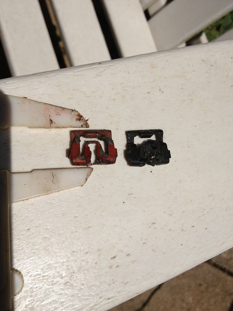

    And here are some Red and Black ones that David (predfan2001) posted in another thread:
    (*from a 1970 Maverick. Not positive whether they're Factory or Aftermarket)
