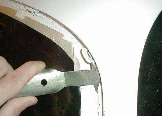

    Ok sliding them off didn't work until I released the outer retainers. I did manage to finish getting the windshield out tonight and for future reference, here's my "Windshield Removal for Dummies Like Me".
    1. Remove the top molding using a nylon wedge tool to gently pry the molding up so you can get a molding removal tool in to release the molding retainers. Be very gentle so as not bent the molding. Here's a molding tool at work.
    2. Work your wedge under the side moldings to make sure it's not stuck then pull it up along with the A-pillar to slide it off. This saves the time and effort of fooling with releasing the retainers.
    3. Remove the end screws in the lower molding and use your wedge to pull up the side of the molding. Then take a flashlight and look under the molding. You will see a retainer a few inches inward along the lower edge of the molding, if not scrape around with a pick to remove any sealer hiding it. Take a long skinny screwdriver and insert horizontally from the end of the molding the insert it under the retainer to release it (I tried the tool for this and had no luck for some reason but the skinny screwdriver was the trick). Then grab the molding and pull it outward and off the car. Repeat on the other side.
    4. Take a utility knife and carefully cut the outer lip of the windshield molding off all the way around and then remove it. Take a thin nylon scraper and gently work under between the inside of the glass and the weatherstrip to unstick it. Then using the palm of your hand, bump the glass loose and remove it.
    This worked for me after I figured it out. When I do it again, it should only take 10 minutes or so. (y)
