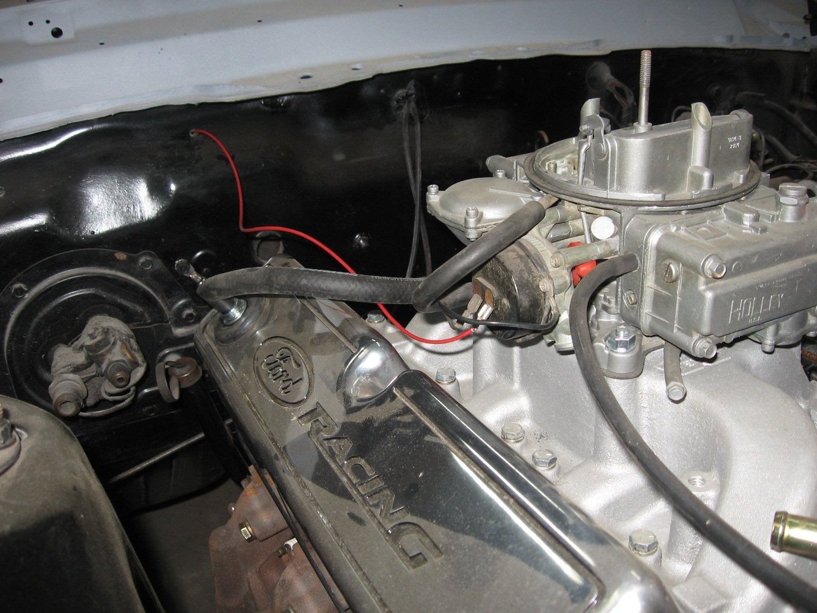

  9. Krazy Comet
    7,796
    2,481
    Assumin' it's a PCV valve(and not a open vent), connect to the vac port on intake, one that's pointed toward firewall. Plug the others off. If port on carb is also full vac, plug it as well. Connect ported vacuum on carb to vacuum advance diaphragm. Smple..
    Ford moved PCV valve from passenger to driver side in 1970, looks like your valve cover moved it back to passenger.
    Moral? Kept the bosses nephew in a job. As long a fresh air can flow in one side, through engine and back out other side, makes no difference were valve is installed. I moved one on my Comet from diuver side to passenger, using 1967 hookup & vented oil cap. cometenginerightsnip.JPG

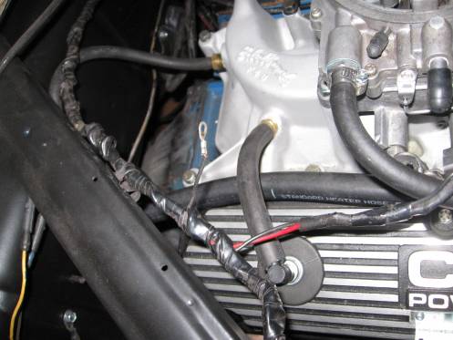

  10. smegnl
    smegnl Roger Saffle
    Apr 3, 2010
    2,326
    337
    Wadsworth, Ohio
    1970 Grabber Clone
    Thanks all. I hope i did this right. Top is drives side bottom is passengers.
    I hooked the drivers side PCV to the bottom carb plate.
    Put a little filter on the passengers side.
  11. stumanchu
    stumanchu Stuart
    Feb 2, 2016
    1,380
    565
    348
    Portland, OR
    That should get the job done. I messed around with a couple pcv valves until I got one that seemed to draw enough air though it to make me think it was working.
    smegnl likes this.

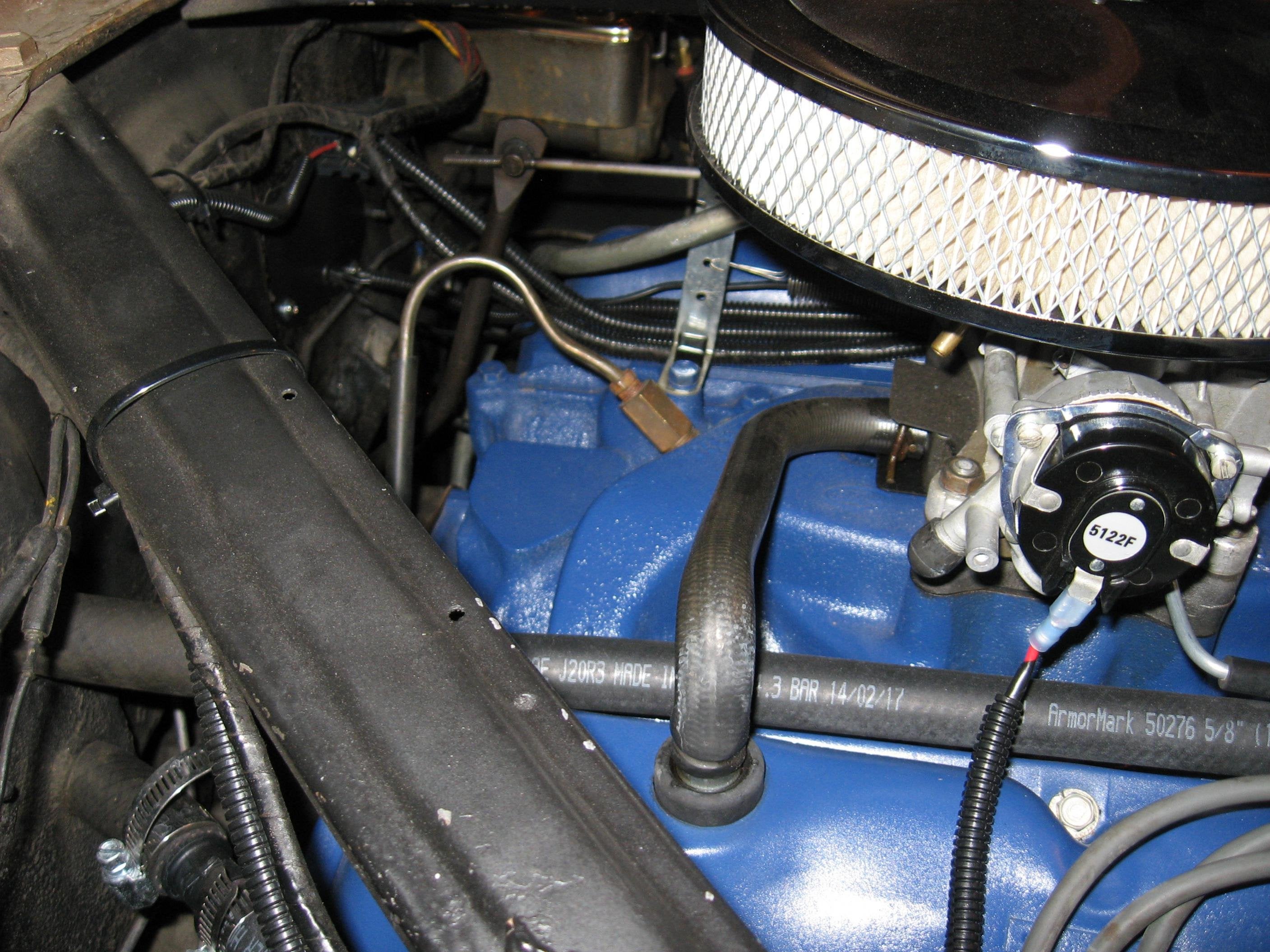

  12. Jaybee
    Jaybee Member
    Feb 17, 2019
    527
    253
    Hampton Roads, VA
    1974 Maverick
    Yes, that filter on the vent side will work. Factory setup usually has a hose from the bottom of the air cleaner inside the filter to draw filtered air into the engine. That connects to the oil fill cap. The opposite valve cover has the pcv valve and the hose from there connects to unported vacuum at the base of the carburetor...on stock motors normally a pcv spacer between the intake manifold and the carburetor. By drawing filtered air into one valve cover, into the vee, and out through the opposite valve cover it ventilates the entire engine better.
