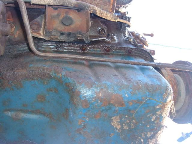

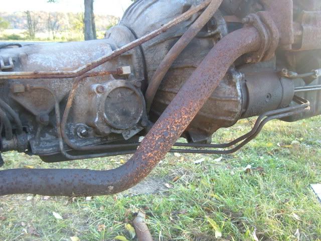

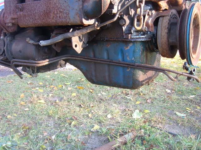

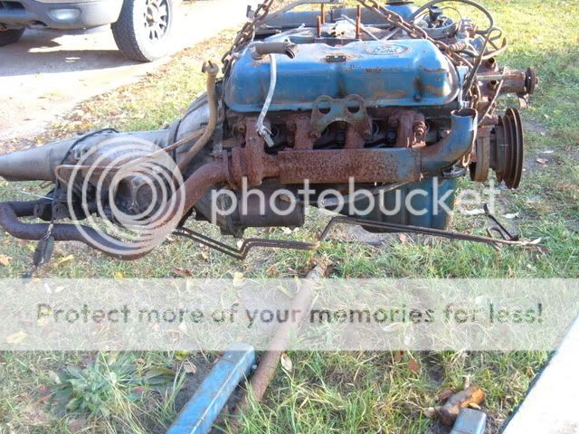

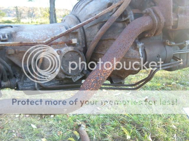

    If you need more pics let me know and I will take some of mine. I have the engine and trans out of the car and the lines are still attached to them.
  2. spork1o1
    spork1o1 Member
    Jun 6, 2006
    626
    Michigan
    got some pics.
  3. scooper77515
    I recycled the steel lines minus the front and rear 6" or so. They are already bent to route around everything and dissipate heat through their metal walls.
    I used rubber hose for the last 6-8 inches on each end, for flex and to fit the fittings I have on both ends.
    It is easier to buy the prebent steel lines (if you can find them) than try to bend them and make them fit.

    yeah thanks alot louis those pics really help alot.but i do have one already done but i will use your pics to route the other one.or i may just scrap the one i bent and rebend another one.

    The best tranny lines pics I have ever seen :).
