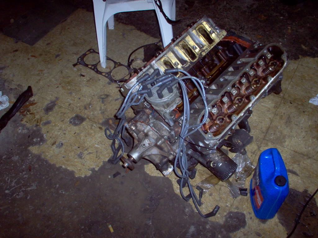

    I found this one from fairly recently.
    A guy grabbed a set of heads at the yard and mocked them up on his block.
    He doesn't even realize that he doesn't need a special cam or distributor.
    Just use the entire top end and computer for the LSx and it'll supply fuel
    and fire with out carb or distributor.

    Well, the LSx intake won't work. :(
    The cylinder block is offset opposite of the SBF.
    Also, the LSx block deck height is 351c, which is really a good thing as the 351c has a 'dry' intake like the LSx, but if you have to make an intake, you might as well use what ever block you like.
