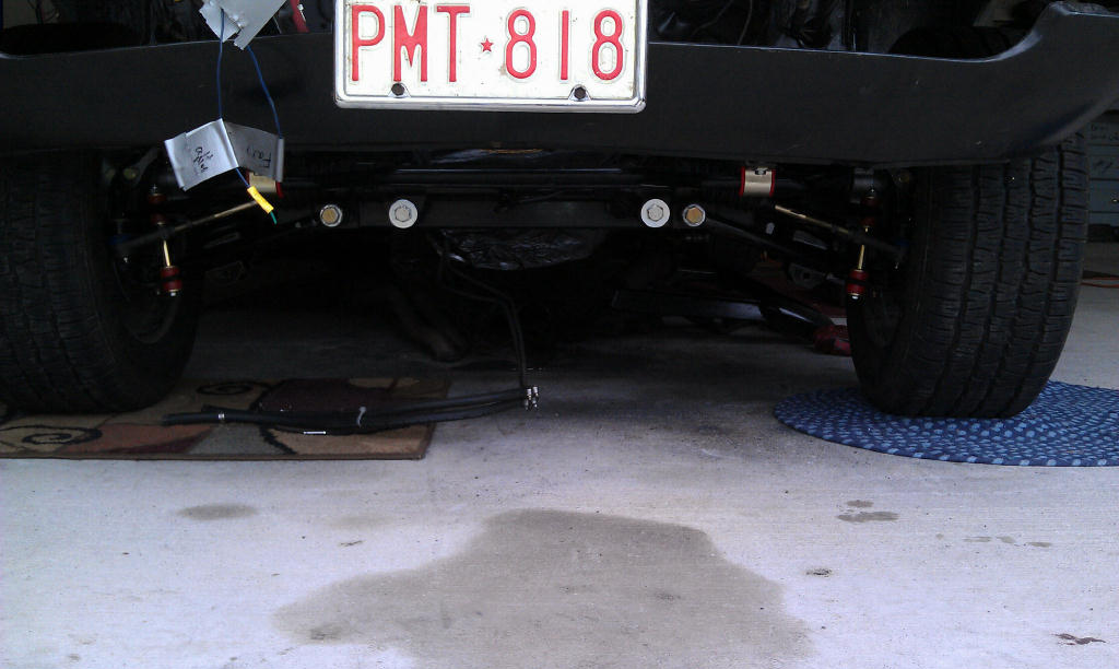

  9. scooper77515
    This picture is before the engine was in.
    Those bottom A-arms are supposed to be level with the ground, and now that the engine and trans are in, they are still pretty angled. The suspension is out of whack enough that the nut on the rod ends hit the sway bar when I turn them.
    Called R&C and he told me to start cutting the springs until the A-arms are level, which should also bring the car back down to closer to where I want the rake to sit at.
    Cutting springs is a typical part of this installation, and I knew I was going to have to do it, but I am surprised I will need to cut it enough to lower it maybe 4".
  10. scooper77515
    Cut one complete coil out of both springs, and the lower A-arms are now level (but not in this picture, I just set it down off the jack).
    And I ended up with Hedman shorty headers because they hug the block better and don't interfere with the steering linkage as much.
