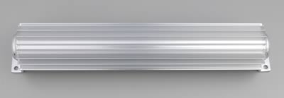

    Transmission cooler is in the mail, should be delivered by Wednesday. Looks like this...
    Thinking about running it installed to inside the frame rail beside the transmission, with new 3/8" steel tubing in and out.
