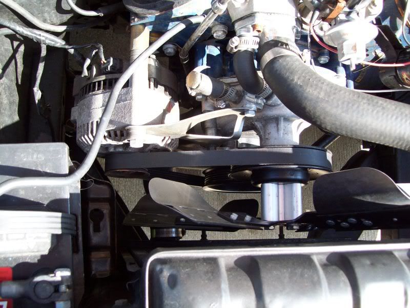

    I used a serpentine style belt on my Falcon using nothing but junkyard pulleys. I used a fox body 5.0 crank pulley, 5.0 crown vic water pump pulley (there are actually 2 sizes, around 1990 they got a hair smaller, either will work), and a 3g alternator. If youre not using a 3g alternator, you should be able to just use any ribbed pulley in place of the v-groove pulley. All told including the 3g alternator I think I spent about $30 on it from my local junk yard.
    This picture makes my car look downright hacked, when actually that was far from the case. lol
