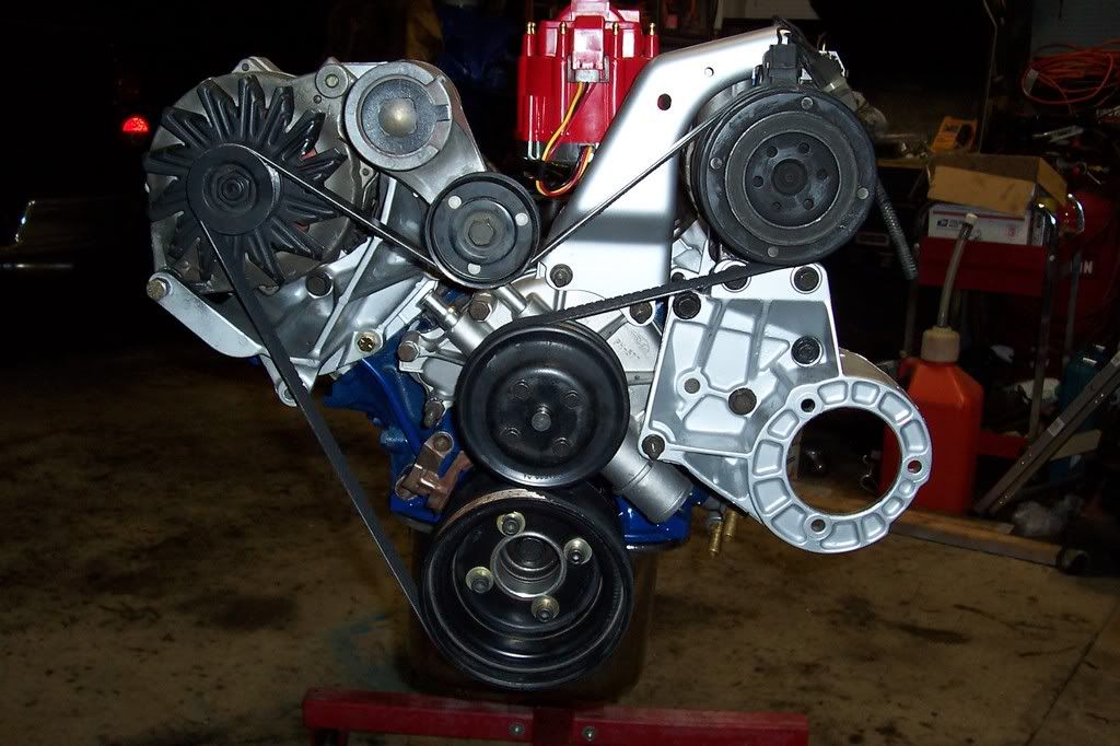

    Reverse rotation water pump, 5.0 pullies.

    this is what I am running also, but I still have the power steering pump on it (I just cut the ends off the hoses on the power steering pump when I pulled the motor at the pick and pull then I removed the old lines off of my car and went down to the industrial hose supply and had them make me a new high pressure line, it cost me about $25 bucks with a new fitting on one end, the pump side end was not in stock so they just used the fitting I had the low pressure can be gotten from autozone for about $4.50 a foot around here) and i got a smog pump delete pully cheap off of evil bay so I am still using the stock length belt
