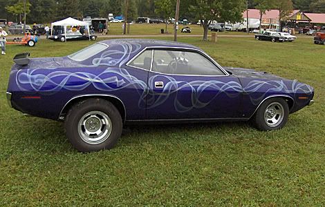

  13. PAINTANK
    PAINTANK Cometosis Obsessivus
    May 27, 2007
    South Central, North Carolina
    1973 Comet 2 dr
    My reasoning is I like 70s custom look. I like small and talls with wide back tires that stick out and not the skinny dragcar tires up front but slightly undersized. Similar to this:
  14. Jeff S
    Jeff S Member
    Jul 13, 2008
    894
    80
    NoVA
    none
    THATS what I'm going for :thumbs2:
