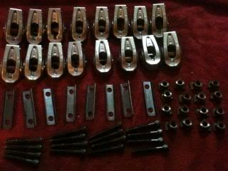

    Here are my rockers...interestingly, when I type in the Ford stamped numbers, these come up as 1.72, not 1.7...F3ZE-6529-AB
    If you go this route, USE LOC-TITE!!! I had one come out while passing another car, and when I got in to fix it, 2 more were loose. I pulled them all and acetoned out the holes, and loc-tited them in.
    Also, those came loose the day after the dyno, so I may actually have dyno'ed it on only 7 cylinders.
