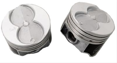

    I missed this post the first time around... There are no holes in any of the pistons, that's just a casting mark. Notice how this pic from Summit shows the same "hole" you see in the top my my piston:

    Damn that's some deep reliefs. The "hole" as you call it is probly to determine the "front" of the piston.

    I didn't call it that. :D I think you are right though.
    And yes, the reliefs are pretty deep. 12cc, practically a small dish.
