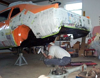

    I'm sure Craig's car will be primo ... and no rotisserie ...

    Guess I will have to add Lonnie's car to the list of one'sthat I want to compete against.:evilsmile That thing is looking good dude!!!! I don't have to worry about Craig because my car will be on it's third restoration before that orange car moves under it's own power:rofl2: :D
