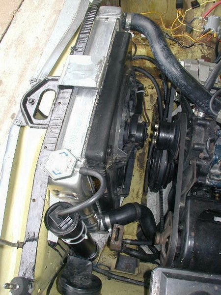

    I did my elec fan conversion abt 10 days ago. Along w/ the fan I did the Champ rad upgrade. I have a 16in. fan w/ 195/175 off Jegs controller and new 180 stat.
    I installed all this stuff drove the car and it worked fine as long as I was moving. When I let the car idle for 15 -20 min the temp went to 230 that's when I 'd seen enough -shut it down. This was on a day the temp was only in the low-mid 60's.
    I wud like to stay w/ the elec setup If I can work out this issue. I have had some suggestions here on what I may need to do to resolve this.
    One suggestion, I don't have air going through the fan when idling. I do have a lot of space the air is not being drawn by the fan. Well, I will see abt fabrictating or trying to find something in the boneyard. I will be out of town for a week so things on hold.
    I have the PS pump off now for rebuild and some other repairs/upgrades so have'nt had the engine running.
    I have seen so many here use this setup successfully - that Im inspired to work with it. Here are some pics of what I have done so far - All Suggestion Welcome.
    Before this change I was using a 160 stat, stock rad, fan and shroud I never got over 215 in hot wx idling.

    Hmmm. My setup is similar, except I have a shroud that covers nearly all my fins on the radiator. Even when outside temps are mid-80s, it takes my car about 5 minutes to get up to 180, and never goes over 185-190, in traffic, idling, and stays right around 180-185 when driving no matter what the outside temps are.
    So, is it just the extra shroud keeping mine cooler?

    I'd say yeah, most likely it is. I used to have a 16" fan nearly identical the chrome one you showed in your link, but black. Probably the same one Mojo is using. Although I was dubious of its advertised CFM, it did move plenty of air. But it barely kept my engine within acceptable temps. After switching to an Escort fan assembly with a shroud, the trouble ended. 195 with the AC on, idling in traffic on an 85 degree day, no problem. It might even go lower if I adjusted my fan controller, but my engine seems to like that temperature.
    Anyway, the Escort fan is actually smaller in diameter than the fan I replaced. The shroud makes a difference. (Might also have something to do with the bigger blades and stronger motor too though, I'll admit.)

    Seriously, put a fan shroud on the radiator. The swept area of the fan blades isn't large enough to do the job without one. From the pics it looks like a good 1/3 of the radiator isn't getting any air movement unless the car is moving.

    Thanks for the suggestions on my fan problem. I think u guys are right on the shroud. I've had almost unanimous agreement on the fact I need a shroud.
