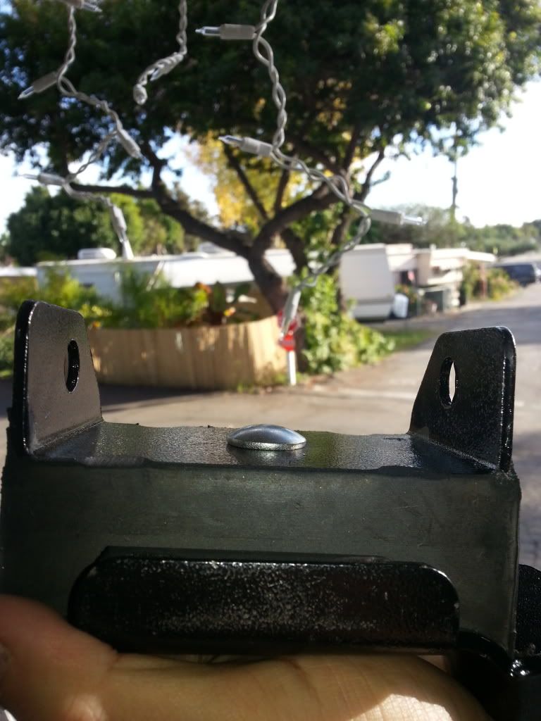

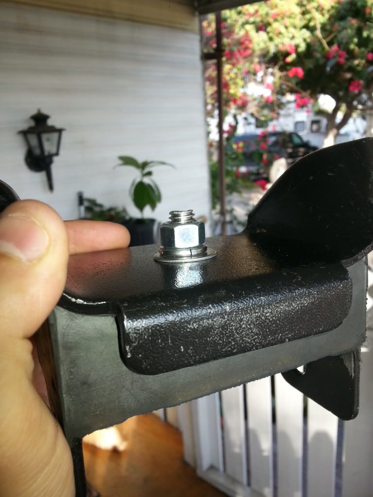

    I just recently pinned my mounts.I went looking around everywhere for pinned mounts and couldn't find them.I ordered some from carquest and they were regular mounts not pinned.I seen that autokrafters showed their mounts pinned on the catalog so I bought them off them but to my surprise they werent pinned. Rockauto also had them but the unpinned type.So I pinned them myself.After I took off my old mounts I found out that they were the factory pinned mounts but the rubber was completely torn on the drivers side the only thing holding it is the pin.When I tried to install my new modified mounts they wouldn't fit because the carriage bolt that I installed is sitting too high and it interferes with the frame mount so i will need to either make the head of the carriage bolt flush with my motor mount or drill a hole into my frame mount so the head sits in there without getting in the way.I will post pictures in a little to give you an idea.

    Heres how I started..I used a 5/16 carriage bolt with a washer washer lock nut and 5/16 hex nut.
    Heres the round head that I Need to make flush with the mount or drill a whole in my frame mount so it doesn't sit right on the mount

    What about a countersunk allen head bolt. Do you think there is enough material in the mount to counter sink a hole and have enough material that the bolt head would not pull through? Or how about dimpling the area in that half of the mount so the head sits lower like the original mounts?

    I asked for a countersunk bolt at home depot but they didn't carry them in big sizes and I had already drilled my hole. I am thinking of dimpling the area like the factory pinned mounts

    That is how I did mine, click on picture on my earlier post. I did grind the bolt head down a little bit. There's enough of metal using a counter sink bit.
