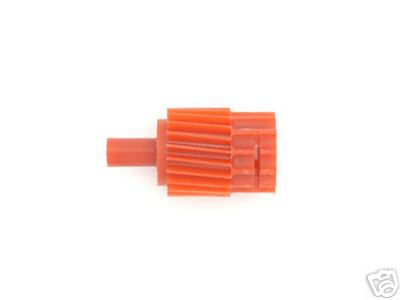

    That's a manual trans gear. The automatic uses one with a longer tip. Color has nothing to do with the transmission it goes with.
