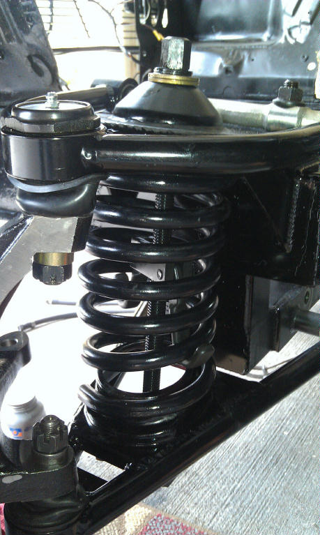

    With the 4-hook model, you don't need to worry so much about it popping out and heading into the atmosphere. It is pretty much secure, as long as that huge bolt in the middle doesn't snap.
    With the mustang-II suspension I put in, I pulled off the top hooks, and placed several greased washers on the upper spring mount, and I can compress everything until it comes apart, and cut coils, add new ball joints, or whatever. No mess, no worries, no problems.
    Kinda hard to see, but the bolt head is on top of the spring hat, and the hooks are down pulling things up where they need to be.
