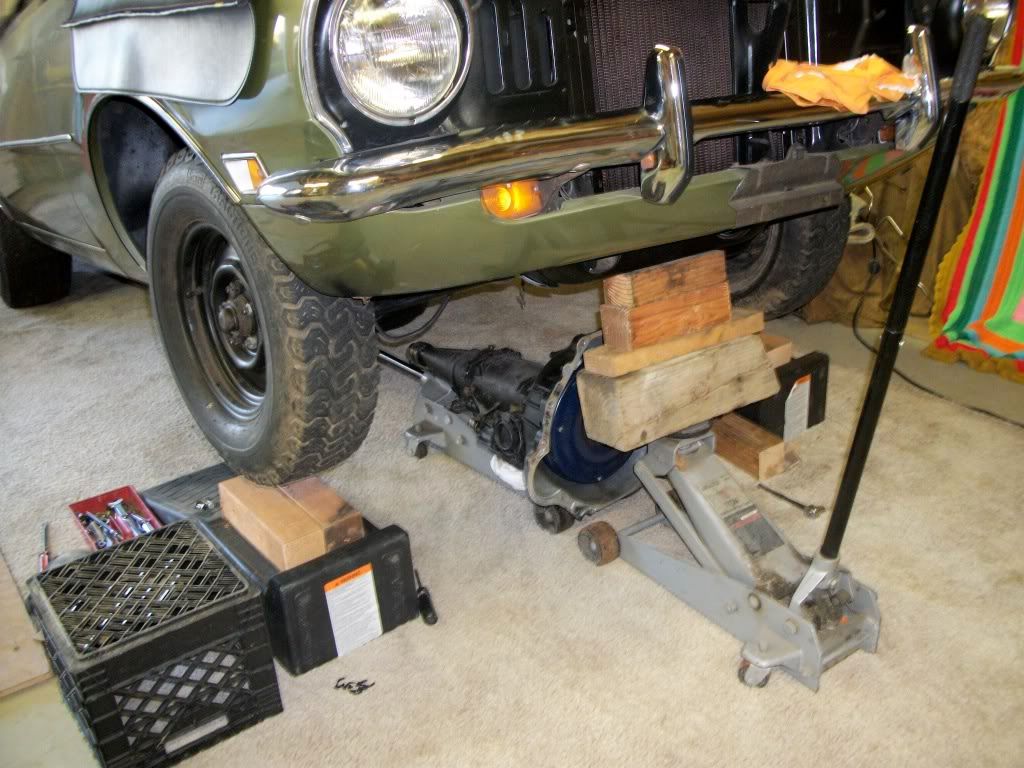

    Nah, i'm taking out the tranny cause i got the wrong flexplate!

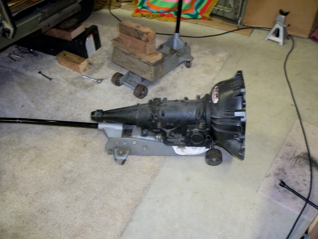

    Its cool, the nut broke free pretty easy and i got the tranny out. ->
    [​IMG][/IMG]
