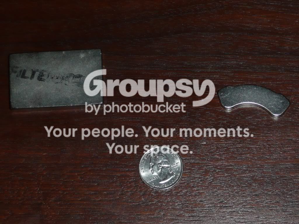

    Hard drive magnet.
    It just so happens that I have a near endless supply of hard drives that I can pirate magnets from. I opened a Seagate hard drive from a Dell PC, and layed out the magnet next to a FILTERMAG DM101 for comparison.
    Here are my observations:
    1. Of the two, the larger DM101 is stronger around the edge.
    2. Of the two, the hard drive magnet is stronger on the large flat sides
    3. If you are not careful while comparing strong magnets, you will inadvertently snap them together on your finger pinching you as bad as you have ever been pinched, causing tremendous pain and a sudden outburst of profanity.
    Bottom line is these hard drive magnets are definitely worth grabbing. They are quite strong, I would guess the total magnetism is at least as much as the DM101. Definitely worth while throwing into a transmission or rear end. However there is no practical way to use this magnet on an oil filter. Again, thank DaMadman for this useful info.

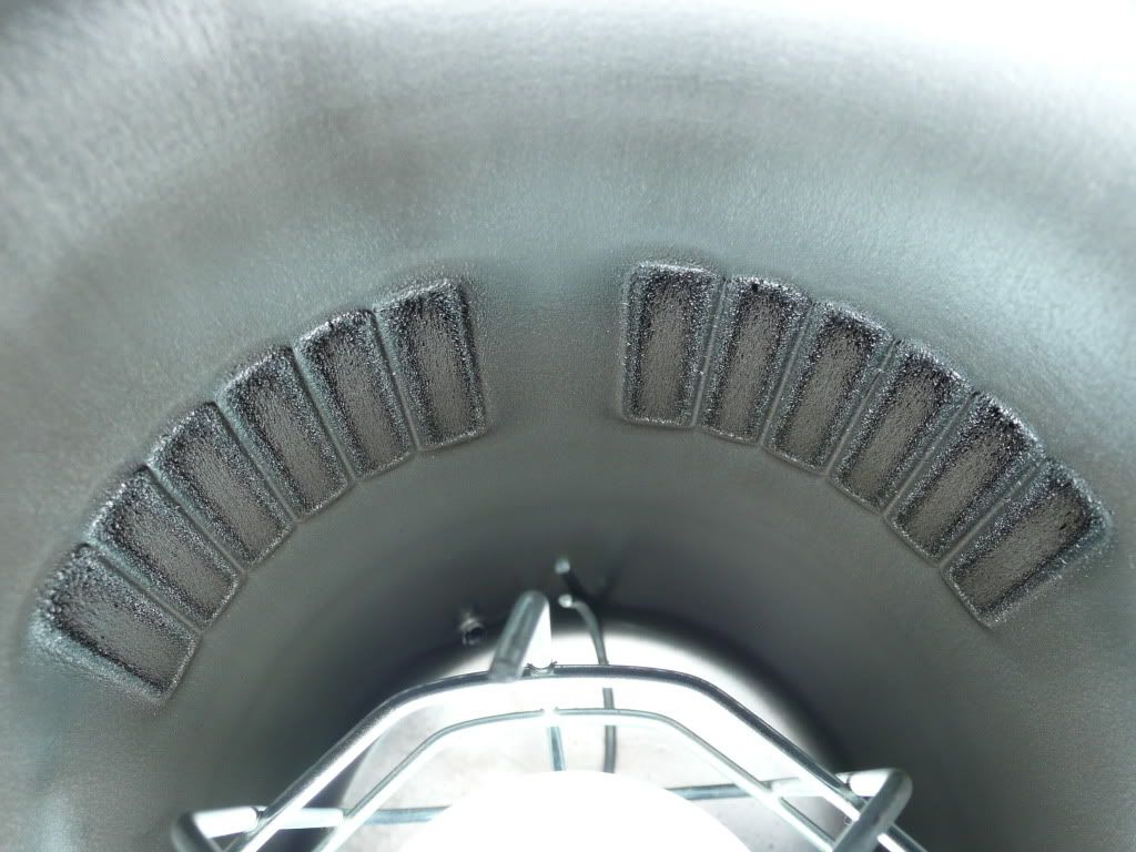

    Brand new 5,266 cubic inch twin turbo V20 Caterpillar G3520C Genset. - RA450 Filtermags. [I AM smiling.]
    Same filter cut open at 1000 hours.
