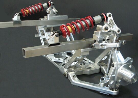

    Cantilever suspension is just plain badass. Like I said.. a car is far more than just it's suspension design alone. Each design can be reengineered and tuned for the drivers individual style and end up beating up on another car with a "superior design".

    Some of you here are speaking in absolutes when it comes to these suspension design choices.. but this is just a Maverick.. not a high dollar GTO racing class with pretty much carbon fiber everything covering ceramic rotors with billet aluminum and magnesium sprinkled everywhere it can be used to cut weight. If you're seriously looking for state of the art suspension.. or for that matter, state of the art anything.. you surely won't find it being sold for this car. Not many here could ever fully realize the potential shortcomings of any one of the designs being discussed here if it were fully tuned to perfectioin anyways, so pick your poison and drink it down while you enjoy the ride.
