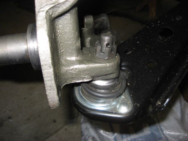

    The Laural Mountain parts are for the most part only fair... I had to replace the spring perches as they were noisy from day one, ball joints are machined with a too long of pin, will need washers or spacers under the castle nut(BTW my control arms were made in Mexico)...
    You won't find a new center link, Maverick is shorter than anything similar... The idler arm is same as similar year Granada, no problem finding those...
    The late control arms I've seen marketed on ebay as Moog appear to to be same stuff I got from Laurel Mountain...
