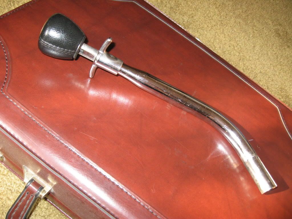

  10. krelboyne
    krelboyne Remember
    Aug 1, 2006
    903
    97
    115
    Salem, Oregon
    I installed this lever in my 1968 Cougar with T-5 conversion. It came from a 1980's? GM product with automatic. Originally a cable release, I removed the cable and installed a spring under the shift knob, so it still feels functional (it isn't). I think I paid $15 for it at a swap meet 10 years ago. I have no idea what it is originally from.
